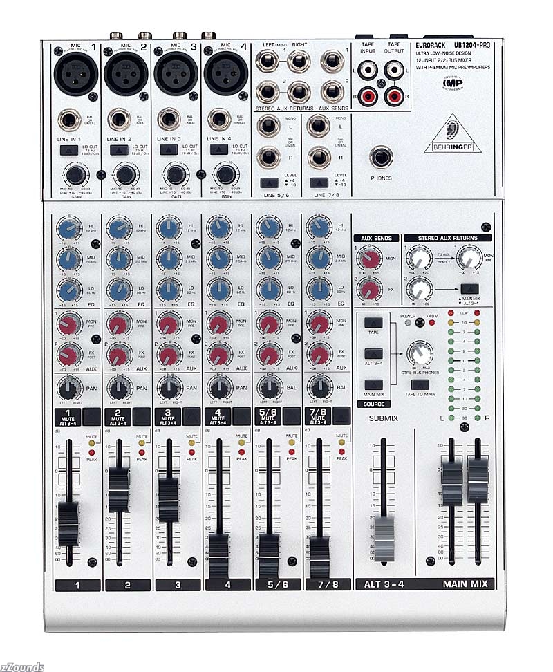

Behringer UB1204

I have a UB1204 with the built in fx. some of the fx are ok, but I really don't use them much. Go for the plain one and save money. I use mine to get sound into my Korg D8 from a SM57. Works well.

Anyway, would it be possible to output the Behringer into my M-Audio Fast Track via the Headphone port on the Behringer, and into the instrument input on the Fast Track?

A lot of people here don't like Behringer for some reason. I've been using a Behri mixer for over 3 years and have never had a problem with it. I don't use its preamp but everything else works like a charm. Also I wouldn't run the signal out of the headphone jack. Use either the Tape Out or Main Outs. You'll probably have to buy some special cables for them but don't worry, you're local Radio Shack probably has them. If not in the store, on their website. Peace!

Always use a real line out from your board. Headphone outputs are not designed for recording from.

the quality question on Behrenger is valid, they have made some pretty ordinary gear in their time, but remember they are aimed at the budget end of the market. Also Yam. and many other reputable brands have made dodgy products from time to time. My Bere. has done me fine, but you should chek them both out and see what suits you. I'm guessing they will have similar but different features. Yam make good gear. Now, going into a computer sound card or breakout box, there are two sets of balanced outs, the "main" and the "control room", also tape out's and two aux outs; take your pick.

Are the main and control outputs on the mixer not R and L each? Because I only have one 1/4 input on my Fast Track. Could I get an adaptor from the tape outs and put that in the fast track, or would that lose quality? Or have I got a huge misunderstanding here?

Should be a 1/4" stereo in. You can RCA the line level out to a RCA to stereo 1/4" adapter.
