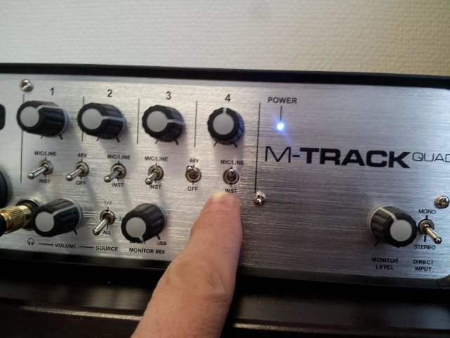

Hello.
I have got 2x2 C-2 microphones. Unfortunately I don't get the proper sound level. I want microphones that I could place in the hall and record, not so close-up mics.
Unfortunately the input is very low on all 4 microphones.

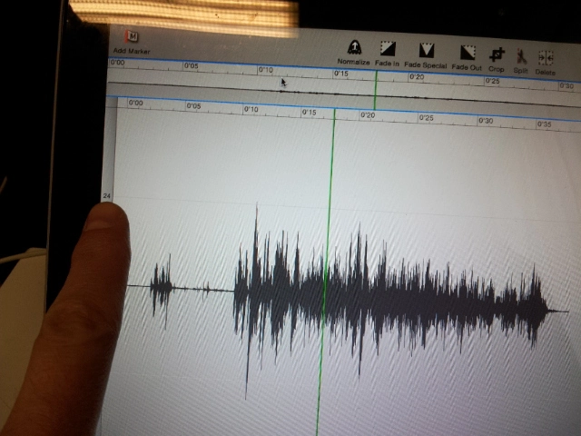

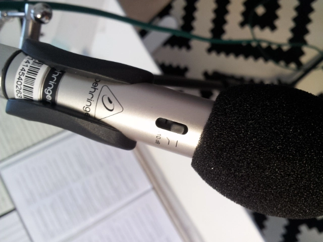

EXAMPLE (see pictures): If I have 48V ON, flat limiter (–), superior mic cable and computer, and I put on the sound card half input (50%) and the distance is 50 cm, and I play STRONGEST POSSIBLE the violin - than still I don't get the correct volume (max -24dB!). It is ridicilously low. I cannot record anything more than a half meter distance without problem.

1. M-AUDIO M-TRACK Quad
2. M-Audio MobilePre USB
Just to note:
1. This is affecting all four C-2 microphones
2. The volume on the audio device input is put on MAX.
3. In the recording applications (Logic, ProTools) it never goes to peak clipping even if the input is on MAX in both sound card and recording application. It is virtually impossible. The Low Cut filter and Signal Level Attenuation is not turned ON on the microphones.

If I put recording at 50% level on the sound card (what is a normal setting) it records a distant sound (-40dB).

The purpose of the input gain is to account for different microphones and different sources. If you need to turn it all the way up to get a decent level that's okay.
There's no need to let peaks approach within 6dB of clipping, and -12dB peak/-18dB average level is a pretty good target. Peaks around -24 are somewhat low, but you can manipulate levels digitally after the fact if you need to. It's normal for levels to be low during recording and mixing. They won't be at their final volume until they've been mastered.
The only real issue is if your preamps are adding excessive noise with such a low input level.
Mics likely OK. They don't have an output like an LDC (14-25 mv/Pa). The C2's are about 8.9mv/Pa output, about average for an SDC. The mic preamps on the M-Audio interfaces from what I can find are rated about 40dB maximum, so likely you need to run them at max and bring up the levels later as bouldersoundguy suggested.
