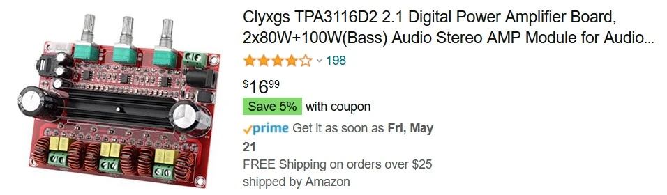

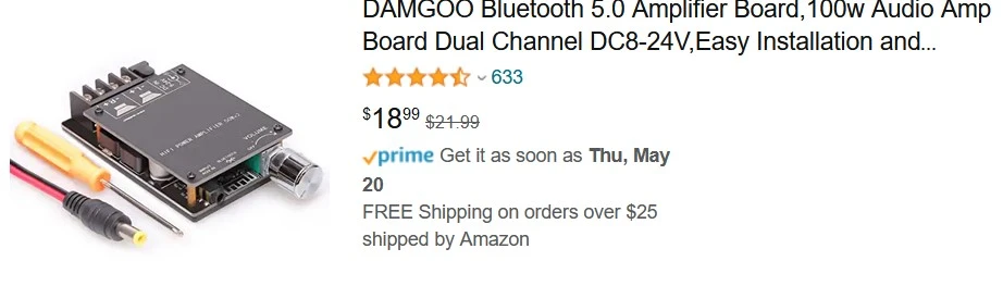

I would set it up 12 volt. Not a 120volt system. It doesn't need to be 120.
A DIY amplifier board should be fine. Its a outdoor system so you need some power, 100 watts should do. 12volt. Use car stereo speakers with it. Use 6x9's free air. To the sides of the backpack.
this one can power a sub too. Are you gonna carry around a bazooka tube? Shoulder mounted perhaps..or secured to the packs base.
At 12volts the battery bank will last longer.

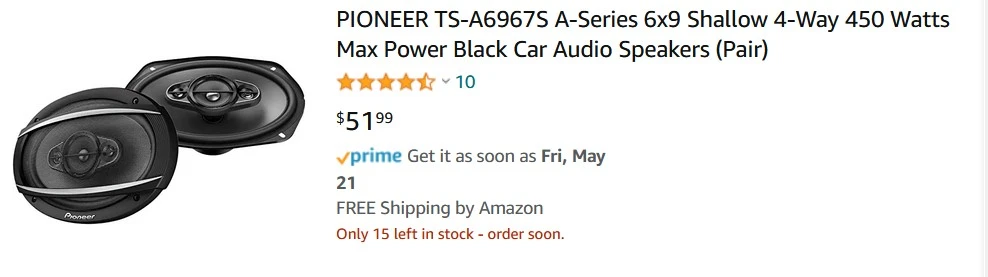

6x9's make surprising amounts of bass and sound full. Get shallow type and use free air mounting. Can top mount in a cardboard(for shape/so no crush) open enclosure too. Can also attach, or sew, plastic 6x9 enclosures to sides of pack. Save space and weight, and sound great. 3 way model is $19 on ebay for a pair.
