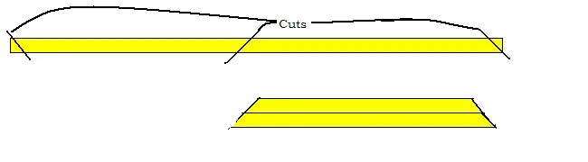

I recently had a small bit of wall above the door that I felt would be a good place for a bass trap, So I took a two inch panel of leftover 703 and cut it on the slant to make a four inch thick bass trap with a just over one foot diagonal face. Here is a diagram looking from the two foot edge of the panel

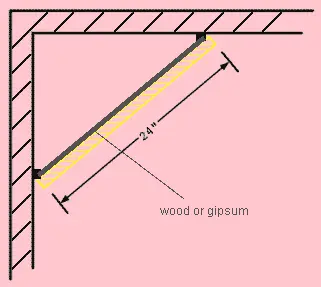

Can i make this trap by gluing the fiberglass on gipsum boards or wood boards or must it be only fiberglass???
Do I fix it on the wall or must it be selfstanding and little away from the wall??

can u say Hi -jack? :rolleyes:
just kidding man, but being a noob I will try and give you an answer. yes it can be attached to wood and if you have it straddling the corner like in your diagram then it will have space behind it.
