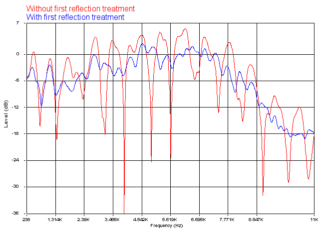

Ethan Winer said:> I understood that 8lb behaves less well in the LF because of grazing - sound hitting at an angle. <
No, you have it backwards. But in practice, higher densities are fine for first reflections too. I tested this recently at the first reflection points in my living room system, and you can see that 705 does a fine job in the before / after graph below.
--Ethan
