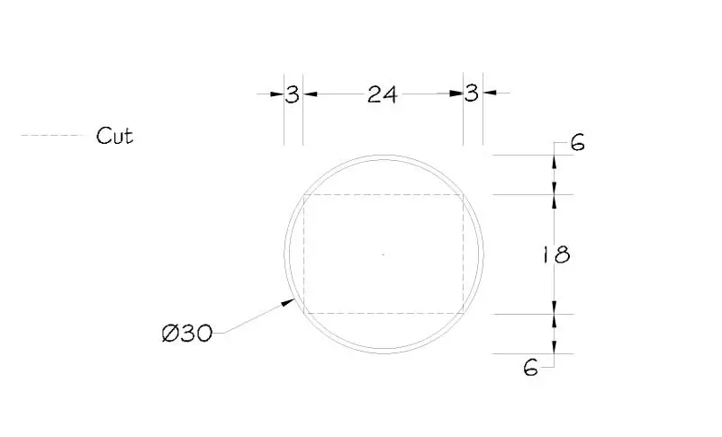

try those huge cylindrical cardboard things. you know, similar to the tubes you find wrapping paper roled up on? you can get these at a construction supply house. they are used to pour concrete pilars. sizes are from 12" dia. to 36" dia. what i did was get a 12 ft long tube 30" in dia., cut it in 4 ft lengths. i then cut the lengths in 4 sections (2) of them 24 in across the back and the other (2) ended up being 18 inches acrosse the back. i then put a plywood back panel on it, filled it with fiberglass insulation, and put cardboard ends on it. walllah! a mid-bass frequency absorber and high frequency diffusor.
