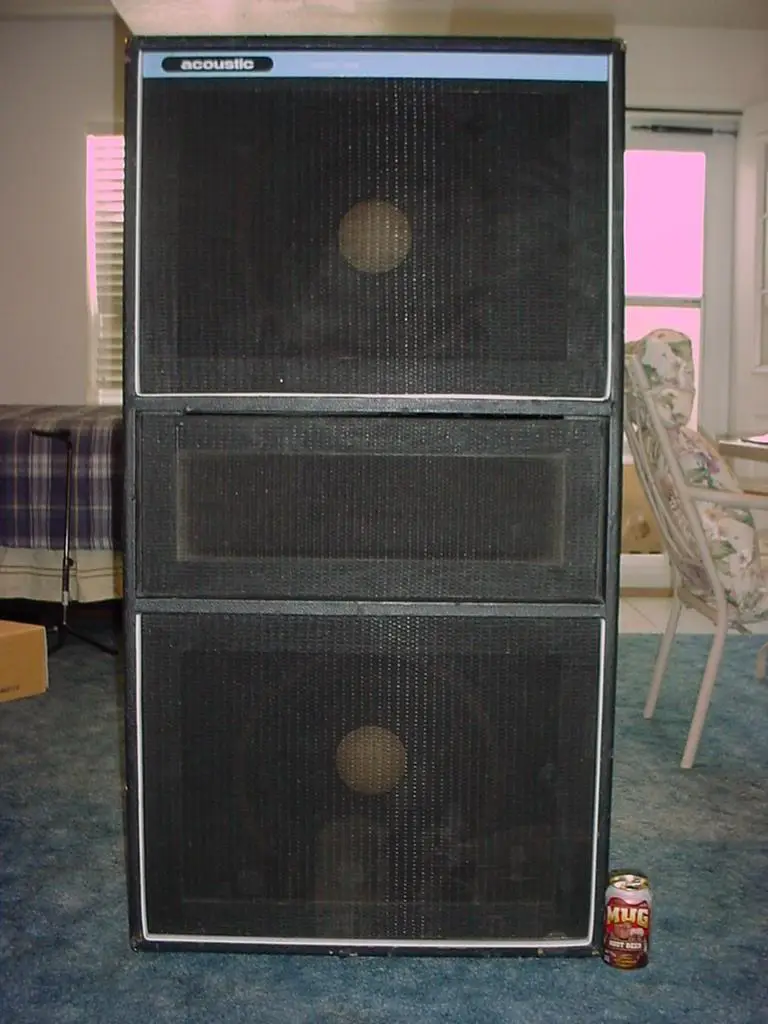

I used to play with a guy that had an ancient Acoustic (the brand) bass cab that was literally almost the size of a refrigerator. It had four 15's in it pointing backwards into these baffles that then "focused" the sound out this wide horn thing in the front. It sounded like a friggin tugboat horn. Really cool piece of quirky gear. Totally unusable though. I think it might have actually been for a PA system.

if I'm right couldn't you see the backs of the drivers when you looked at the cab?
If so that's a PA bass cab.

I don't remember seeing the backs of the speakers as his grill cloth was in good shape, but yeah I suppose in the right light you could see them. The front was solid like an 8x10 but with a wide horn going across the middle. And it had dolly wheels on it, although those may have been added later. It probably was indeed a PA cab. It looked like something you'd see at music venue. He played bass through it sometimes just for shock factor.
Like this??
Sort of, but not really. These speakers definitely faced backwards and there was a big horn in the middle. It was also wider than that. But it was in that style with the blue logo bar across the top.
