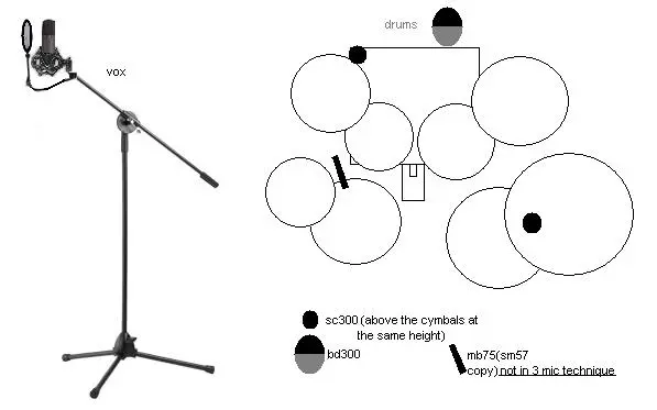

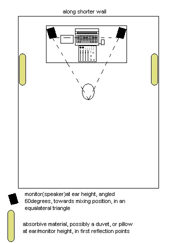

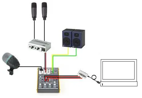

I managed to put together a 2 track setup for my mate for under £300.
I could give you a list of equipment if you wish...
It includes:
outboard preamp,
small mixer,
stereo interface(sound card),
monitors with 6 1/2" woofer,
condenser mic,
sm57 copy,
stands,
and cabling
In total this setup will provide 3 mic inputs(preamps), which will allow you to even record a drumkit in stereo(kick, and 2 overheads). It will cost around £350 with the extra mics and stand though, but this is still under your total budget.
M-AUDIO AUDIO BUDDY
2x the t.bone SC300
2x The Sssnake SM10BK
2x Millenium MS-2005
£114
MACKIE BY TAPCO MIX 50 £30
BEHRINGER U-Control UCA 202 £19
the box NF06 A £102
the t.bone MB75 £24
the t.bone BD300 £38
THE SSSNAKE SRR2050 £5
MILLENIUM MS-2002 £10
the t.bone Mikrohalterung M £2
2x the t.bone SSM 2 £27
the t.bone MS180 £10
THE SSSNAKE SK369S-15 PATCHKABEL £8
sorry. misjudged... £390ish
you could get this mixer for £10 dearer, which would allow you to mic the snare drum while recording drums. As long as you get another XLR cable, and MILLENIUM MS-2002 stand(together around £15).
Here is a wiring diagram, room setup, and mic techniques, for what I've suggested
