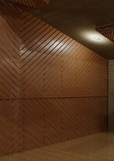

Just curious, are the walls actually brick? Or cinder blocks. I kinda like the look of brick. Anyway, you could always just stucco the wall to make it look better. Then acoustically treat it. I am about to finish walls in my concrete block walled drum room with something like this.
