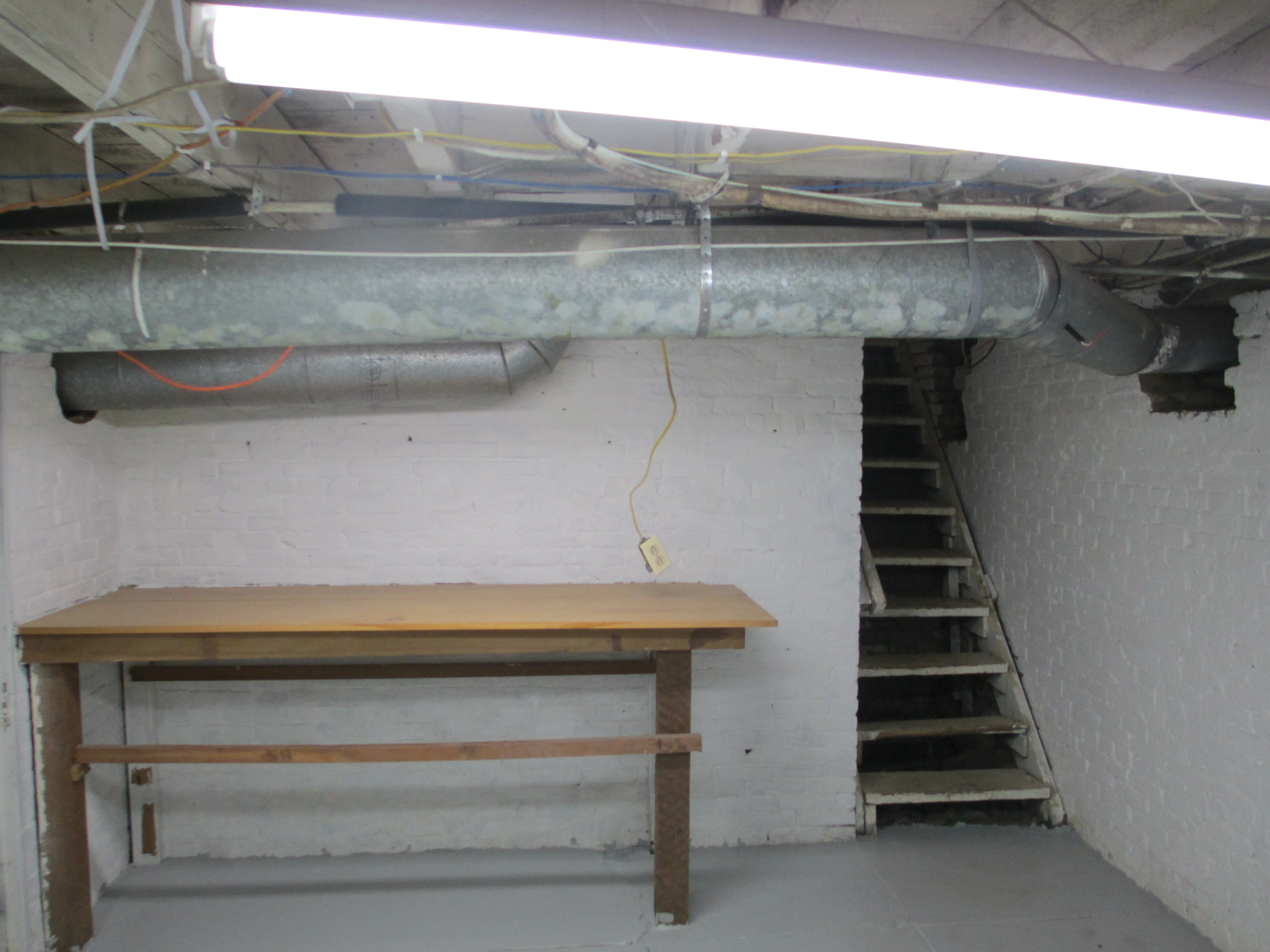

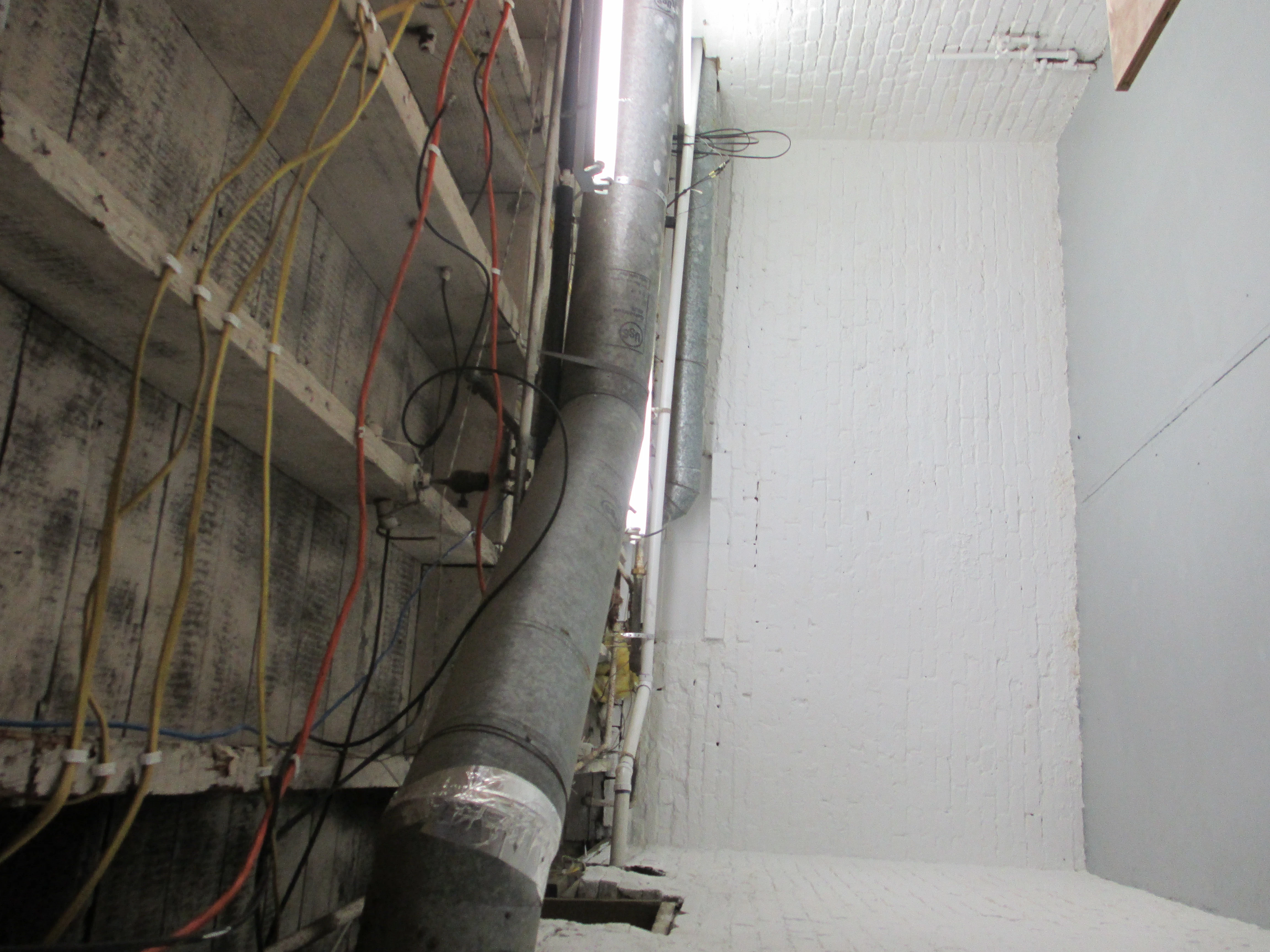

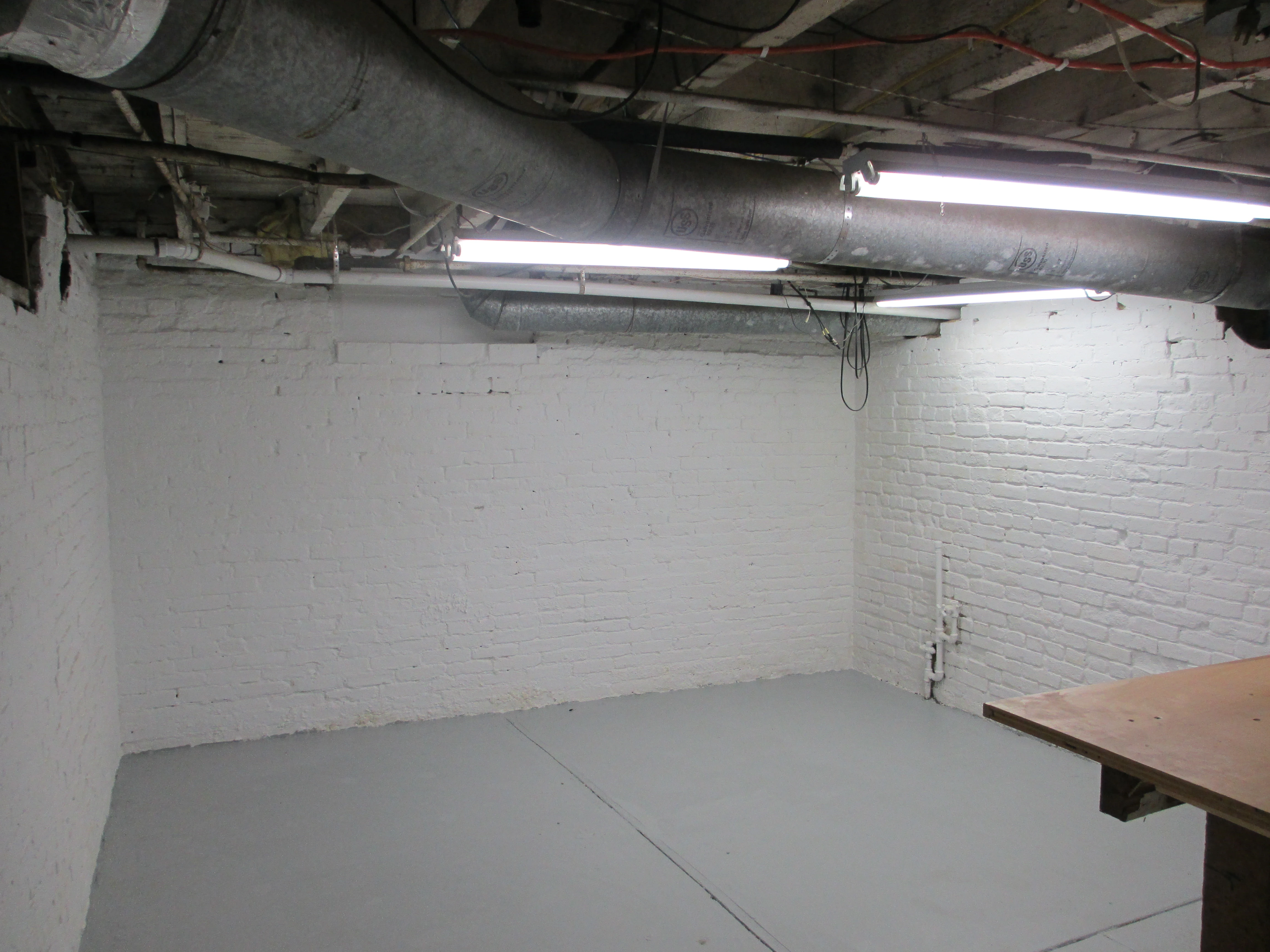

I have uploaded three basement pictures. Our local home improvement store has mineral wool insulation, and they also have have ultra touch and sound control denim insulation. Both of these two types of sound barriers are 3 1/2" thick, and I have a floor joist space that is over 8". Should I use one layer with a 4" air gap? Or should I double it up? I wanted to use canvas as the cloth to cover it or is it too dense? Also, I read that mineral wool has the same sound absorption characteristics as the Owen-Corning 703 panels. I wanted to make wall panels and base traps and was wondering if this would be a good solution? The wall panels that I observed had solid backs, but I also read of panels that have cloth backs and a 1" air gap between the panel and the wall. Does this affect the acoustic quality of the panels? And also, is this a good way to make base traps? I was thinking of making two corner base traps and six to eight wall panels. Is this enough or do I need more? I also have an idea of making the entire back one wall complete acoustic panel. Any suggestions?

That duct work is a problem too. It will carry the sound right out of the house. I'd find a different space.
I've read that the 'recycled denim' sound insulation is worthless. The cover material on any bass traps you may should be 'transparent' to sound, so canvas is not good, burlap is. Leaving an air gap of an inch or so behind the hung bass traps (no solid back on them) enhances their trapping capability. Manslick is correct in that the ductwork is going to transmit the sound right into the house and outside. You could wrap it with insulation (use wire to hold in place). Even the PVC drain pipe will pickup and transmit vibrations.
None of that wiring all across the ceiling looks like it is to code. Be careful about covering it - it may get hot.
Thanks I plan on redoing the ducts
The wiring is 5 years old and was reinspected 2 months ago and he said that it looks good and I don't plan on covering it I'll put the insulation above the wire
Though I am no pro, the first thing I would do is change the duct to equivalent sized rectangular duct to increase ceiling height. Frame around it and 2 layers of 5/8" drywall (including above the ductwork. Then fill the voids between the joists with 4" of Roxul 80. It is stiff enough to cut 1/2" larger than the opening and hold itself in place (proven in my drum room). Leave the remaining air space between the bottom of the joists and the floor boards above. Speaking of which, you might lose a bit of sound transfer by adding some density to the under side of those floor boards by adding drywall to the bottom of them. Any breathable cloth works fine. I used stuff that was meant for backing of curtains. Smooth talked the cloth store lady to give it to me for $2.50 per yard.
I would first build 3 panels at least 4" thick to straddle the corners from floor to ceiling. Any access behind those stairs? If not, cut some 1/2" OSB down to 6" x width of stars. screw them into the bottom of each tread to create a shelf behind/under each. Then push in pieces of 4" Roxul cut a bit larger than the openings. Instant bass trap for that space.
Then treat your side wall first reflection points (from monitors at listening position. You wont need a cloud above you, as the ceiling will already be treated. If you still have some flutter echo, you will need to decide whether rock wool panels will be needed, or in this case, you might be able to get away with some foam panels to save space in the room. Likely two rock wool panels (including the first refection one) on the sides, and one or two on the wall with the stairs should do it. I would not even worry about the wall behind your desk (assuming that is going on the wall opposite of the stairs) , other than the corner traps. I don't have any behind my monitors and don't hear an issue. Though I am also 2' from the wall and my control room is 35' long.
Maybe the thinner black cables looping all over are tv cable? I see an outlet on the wall above the table that does not appear to be GFI with a cable running up from it along the outside of the wall - maybe your wiring codes are different where you are!
Make sure the insulation stays clear from any wires to prevent fire hazard. Rockwool RW3 or Knauf RS60 mineral wool insulation slabs offer great acoustic performance
