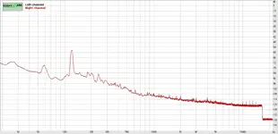

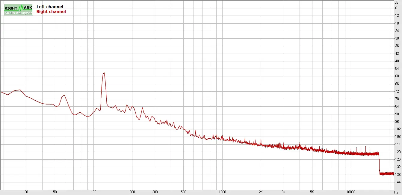

Hi Kira,
The attached spectrum shows two hum spikes (60Hz and 100Hz) and these are caused almost certainly by that microphone. WTGR it IS cheap! It has a very low sensitivity of -70dB which is 10dB, 3 times lower than the Shure SM57 workhorse (and noobs have level problems with those!) . It will have no form of humbucking inside it. Waving it about with headphones on you should find a position where hum is at a minimum but that will not help the hiss which is being generated partly by the mixer.
There is however a second source of noise when using basic 'generic' USB audio devices with Windows, the latter slams the gain up to 100%. I no longer have Win 10 (got rid, sanity has somewhat returned and hair is no longer threatened!) but you need to get into the Sounds Devices and find that mixer. Probably be called 'USB MIC CODEC' or similar. Make sure it is the 'Default' device then look for a 'Level' button. Click and you will almost certainly find it set to 100%. Back it off to 5% (yes, F.I.V.E.) Now you can drive the USB converter harder and get a better signal to noise ratio. Has to be said though, with that mic and that mixer*, never going to be great.
New 'sound card'? You almost certainly mean an Audio Interface and they are legion. One of the best for its money is the Steinberg UR22. Noted to have very clean mic pre amps but you should be looking to upgrade that mic ASAP and consider a Small Diaphragm Capacitor (aka 'condenser') especially if you can find one with a -20dB pad (Google AKG P170, no longer in production but gives you the idea) . Other AIs by Tascam, Alesis, M-Audio, Focusrite are good and models will be found from £100. But, think long and hard about your next spend. Will a simple 2 in 2 out AI serve you for the foreseeable? For another £50 you can get two more line inputs which means the mixer(see *) could be used to give you 4 mic circuits ultimately. BTW, all the AIs mentioned have their own 'ASIO drivers' which means they are out of the clutches of Windows control.
*The X802 is not at all bad. I have one running 24/7 amping up two pretty crap dynamics in my garden but that feeble mic is asking A LOT of any pre amp! If the mixer drove two AI line inputs with 1/2 decent mics it would give an acceptable account of itself I am sure.
Try again!
Oh! FFS, just turned the picky into a .bmp file but NOW it works aswoz!
