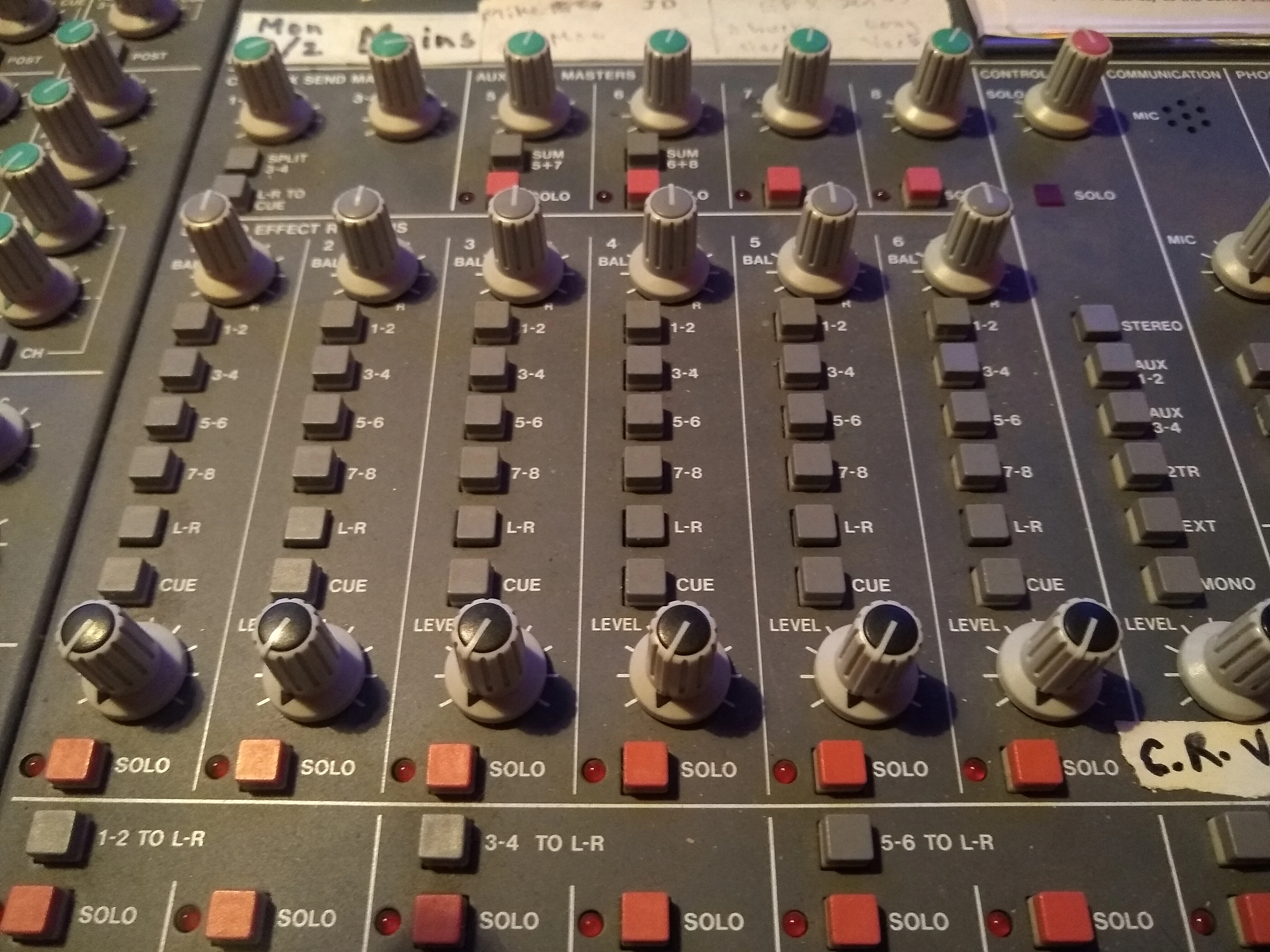

If you're referring to the effects returns, I assume you know that you have to select a bus, either L-R or a submix. I'll also assume the other returns work. Given that, I would start with exercising the switches, pan controls and level knobs. If that doesn't produce some change, it might be time to open it up.
I'm literally running one of those as I type.

Yeah, make sure you're not treating the Aux sends as inputs, because those are outputs. (Most people will know this but just in case it's your first mixer...) Clarification on exactly which socket you're using, and what you're using it for might be handy!
Once its clarified what the actual connection points are, you should be able to resolve any confusion, based on the previous replies above.
Unless a connector is loose due to rough handling, its more likely your issue is human error. I dont see anything labeled Aux Input in the operating manual for the 2600 MkII,
so unless the 2600 (non II) is different, it sounds like you're referring to either EXT inputs or the Aux Send- which has already been explained, is an output. Thus, if you were expecting to hear something and did not, its probably hooked up incorrectly.
