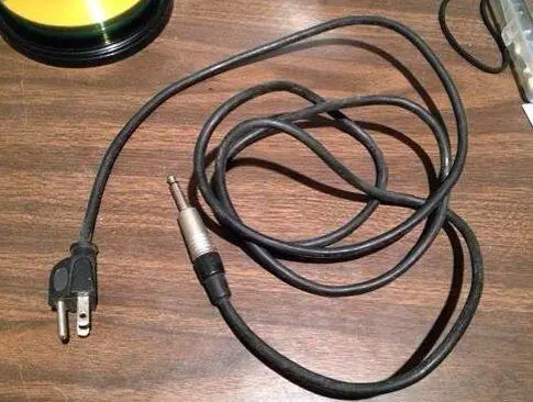

And we can all use one of these for those really special signal routing situations. As you can see, this one is grounded for safety. :D
:p :drunk: :facepalm: :spank: :rolleyes:
I remember hearing about that "special" cable, Tim.
That...
Is some kuh-razy bizness.
I have a Stewart single-channel phantom supply that uses a 1/4" TS jack for power to the wall-wart...has always made me wonder.
