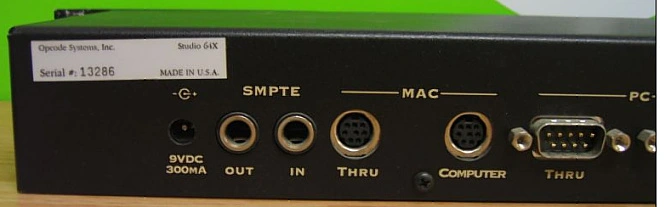

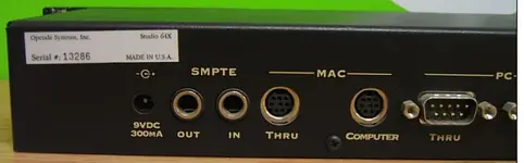

the units like this must at least have two "audio-jacks" (usually on the back), that are SMPTE in/out. Sometimes those jacks marked as Timecode, or LTC or even simply "audio" (if I am not mistaken...???). Again you want a unit that can do this operation without a computer connected.
Search eBay for "opcode" , or "motu midi" etc... if you find something you can ask a question , so somebody who knows/had this specific unit can advise you. You can find a unit like this for cheap, but again, it will be usually AS-IS , so there is a chance that you may get a non-working unit.
here's a screenshot pic of the back of the unit (from that eBay item I've mentioned), that's what you are looking for , then make sure that the unit can be operated without computer (as TODAY! you don't want to deal with this, take my word for this one heh heh :) )
