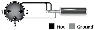

ICD-UX200 Recorder Microphone jack input for plug in power has
minimum input:
level 0.9 mV, 3 kilohms or lower impedance microphone.
ICD-PX820 Recorder Microphone jack input for plug in power has
minimum input:
level 0.5 mV, 3 kilohms or lower impedance microphone.
AT897“The signal appears across Pins 2 and 3; Pin 1 is ground (shield). Output phase is “Pin 2 hot”— positive acoustic pressure produces positive voltage at Pin 2. To avoid phase cancellation and poor sound, all mic cables must be wired consistently: Pin 1-to-Pin 1, etc.
Nominal open circuit output voltage shall be 10.0 mV (phantom) or 8.9 mV (battery) at 1 V, 1 Pascal. Output shall be low impedance balanced (200 ohms – phantom, or 300 ohms – battery).”
Spec. Sheets:
http://www.docs.sony.com/release/ICDPX820.pdf
http://www.docs.sony.com/release/ICDUX200.pdf
http://www.audio-technica.com/cms/resource_library/literature/3b4fdc7559bc013c/at897_submit.pdf
