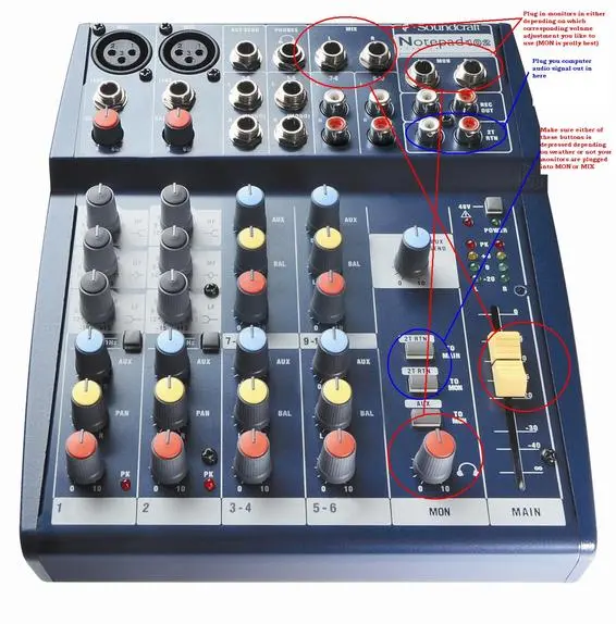

Yo, I would like to play everything through my mixer (soundcraft notepad 102), including my computer. When I plug the outputs of the audio interface into the line inputs on my mixer, I can't get it so I can control the left and right monitor seprately, I can either get it in mono from both monitors, or purely from the right monitor. Help would be greatly appreciated.
Here's what ur looking for
the text came out smaller than i expected....
the red circles around MON and MIX correspond to where you need to connect your monitors.
the blue circle corresponds to where you need to run your Audio out from your computer
after running the signal from your computer make sure the buttons with the blue circles around them are depressed.
enjoy :)
Thanks, but I figured it out with a little common sense.
edit: your ways better actually haha, thanks man
