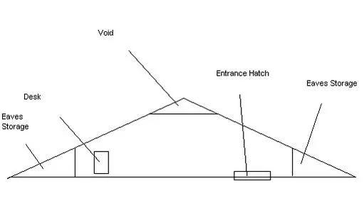

hi everyone. Im looking for advice on my studio project. I have an attic that im converting to a small recording/mixing studio. The attic has a false floor (joisted to the brickwork rather than straight to the ceiling below), and is bare to the blockwork and joists. Im going to be converting it to a proper room so im at a point where i can alter the rooms shape. ie. build bass traps into the corners? are there any advantages to this rather than installing bass traps at a later date. if so, best way to build them? i will be battening out the walls and installing insulation, then plasterboard. same for the ceiling. I have included some quickly drawn up plans, (without dimensions though im afraid, however can easily get it all measured) but imagine the size big enough to get a car in! I do however have alot of stuff that needs storing so when i build the room i will be including access points to the eaves. There is also a dormer window central to the room above the desk.
The use for my studio will be, recording, mixing, and general jams with friends. i have a roland electric kit so can record direct or midi, guitar amp with a great sounding record out, good sounding di output from bass amp also, so am hoping the only micing up im going to need is vocals and some acoustic instruments.
With this in mind, i want to get the best setup for mixing that i can. By my reckoning, the angled ceilings work to my advantage as any early reflection points on the ceiling will be directed into the room rather than to my ears. Another point may be, do i need to bother boarding and plastering the room? apart from external noises (and if im not doing much mic-ing?), and cosmetics! the acoustics dont seem to bad in there. it feels fairly dead when i do the good old clap test (nothing noticable anyway).
Any help and advice is greatly appreciated, i have searched extensively on google for anything similar to my setup but to no avail! all other attic studios seem to be orientated the other way round!
Ta

One thing I can tell you is to pay attention to ergonomics. The sloped walls an attic room produces can easily give you the feeling you are always walking around with your head tilted over, half expecting to run into the wall. It can get very disconcerting, and you find yourself just generally pissed off and/or stressed out, without really knowing why. Less floor space, resulting is smaller "roof walls" is often a very good trade off.
ok thanks, The drawing is a little misleading! The attic space has enough room for me to stand up in all but the ends next to the eaves storage! (im 5'10). And the markings on the side view drawing indicating the eaves storage and void are how im proposing to turn the attic into the room! I already use this room for playing my drums, guitar or whatever but am in the process of clearing out all the crap ive bunged up there in the past 2 years! Trying to rid myself of my hoarding ways! I already find it a comfortable and relaxing place to play! But my aim is to have a proper studio setup there!

It sounds like you already have the first clue and that could be a very cool space. Being oriented the "wrong" way is really good for reflections as you surmised. I wouldn't build proper walls with sheetrock and all that if you don't need them. Get a mix position set up and play some tunes through your monitors and see what it sounds like. Burn a quick mix of anything to cd and play it back in your car to see if anything sounds horribly different/amiss. Then start with some simple bass trapping in the corners, side wall first reflection points and behind the desk and see what you get. I think you can probably pick away at it a little at a time.
The fact that it sounds fairly dead to start is probably a function of the natural diffusion you're getting from sloped ceilings and open rafters. Adding walls and hard surfaces would screw that up. Go with it.
