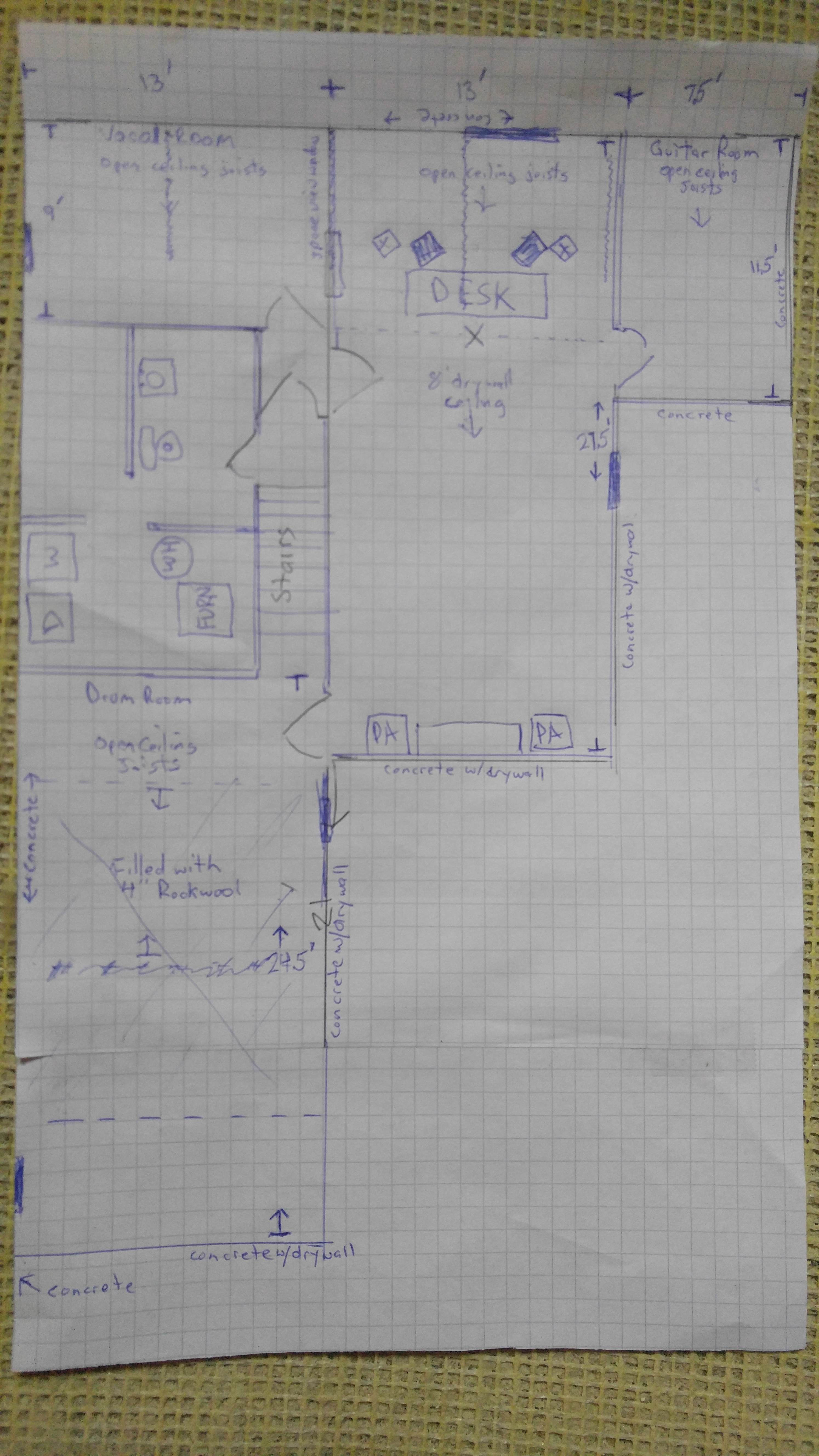

Here is a crappy drawing that shows the space I have and vaguely describes what I have as far as treatment and where I am starting with rebuild.
Any and all advice would be greatly appreciated guys!

All rooms 8' 4" to subfloor above. 10" joists. Only the room with the desk has drywall above. Not even sure I care to have that there.
This is all about making the space the best it can be now. I already have my ideas and thoughts on what I am going to do, but totally open to any ideas and thoughts.
I could care less about sound isolation from above. Dogs can go outside, my daughter and wife usually know what 'shh' means. lol They respect that. :) All the exterior walls are 8.5" of concrete except for the 2 - 1.5 x 3' windows and the 3 x 4' window behind the desk that I am sealing off.
One thing I am not sure about is running of cable between isolation rooms. I have heard of running PVC pipe with angles between floor and ceiling to allow 'fishing' of new cable with minimal sound transmission, but haven't found anything that really verified that. Obviously I do not want to permanently foam in a snake that may someday need repair.
I am not looking for extreme reduction in sound levels between isolation rooms. My vocal room plan involves metal stud framing on each side of the foundation counter-fort, with 4 layers of 5/8' drywall and two fire doors between it and the control room with a 3 layer glass viewing window. I already had the window built. Two 1/4" laminated with 1/2" air gap and 3/8" on the other side. That should give estimated 60dB reduction. That is fine for me.
How much Roxul is 'too much' in the vocal room 'booth'? I am thinking it could never be enough. But, if that is overkill...Maybe just fiberglass on a couple walls? Maybe bass traps in there? I am just used to recording vocals in the treated control room. Never tried an isolation room. Not this size.
For my control room (above desk), I am thinking of 2" Roxul between the joists above up to the last foot at each side. Then 4" thick at 90 degree angle to act as bass trapping at the top corners.
All to be covered with cloth.
Also thinking of building a wall behind the desk with a bottom plate at the bottom parallel to the wall, and top plate curving inward at the left and right 18". I built similar in a friends studio years ago and that seemed to work well. But he was in a situation where he had only 15' between his desk and the back wall. He and the studio building engineer that recommended this were trying to eliminate close proximity reflections. And it really looked friggen cool...
Anyway, if anyone has ideas, options or questions, I would love to hear them! I'm not doing this again and wish to make the best of this. I hope to learn from this and hopefully give insight to others after it is done. :)

Yes, I also agree with the 'big room' theory but even with the crappy drawing, it clearly shows that that is the space I have to deal with. Even with repaired falling concrete walls, I can't make any of the rooms larger. The stairs are where they are. The concrete walls are what they are.
Yes, I do have a reason to break up the rooms into separate 'isolation' rooms. That is the only thing that makes sense. Not only from the way I record bands, but from the way the layout of the space gives me opportunity to do.
I have a quite conveniently long control room and drum room. Wish I had more height...But there is no way to combine them or the rooms off to the side.
Symmetry in a mixing room is my first goal. And that is actually what I am able to do now.
And yes, I do things differently from you. Drums are recorded in an isolated room with video monitoring from the control room. Big/loud PA system in the control room where every other musician is in when tracking drums. All tracks/instruments recorded. Maybe the guitars isolated, maybe not. Direct bass usually. It all gets re-recorded anyway on most projects.
But, now I get to have the ability of treating each room for the particular needs/best use of space for each. This also includes my control room.

I think you misunderstood me, and obviously I was not clear and the drawing is my assuming anyone knows that everything to the left of the stairs (including the wall to the left of my desk location) has no walls yet. They had to be removed in order to fix the foundation. Including the bathroom (except for the toilet as I didn't want the laborers shitting in my upstairs bathroom). Well, except for the ones that are labelled as 'concrete'. By 'building' I meant I need to construct new walls, isolation, and acoustic treatment for that side of the space. I am stressed the fuck out over this so my bad completely for thinking others would know WTF I am dealing with. :(
Sorry Miro..
What I am looking for is advice on treatment and build of the new walls and treating them.
Basically, this crappy drawing is a first sketch of what I plan to do there. Need to rebuild the bathroom and laundry/utility room, and wall to the let of my desk that will have the 3 layer window to what will be my new Vocal Room. Plan on every wall/ceiling filled with rockwool though I wonder if the pink shit is adequate. I emailed JH Brandt and offered to pay him but got no response.

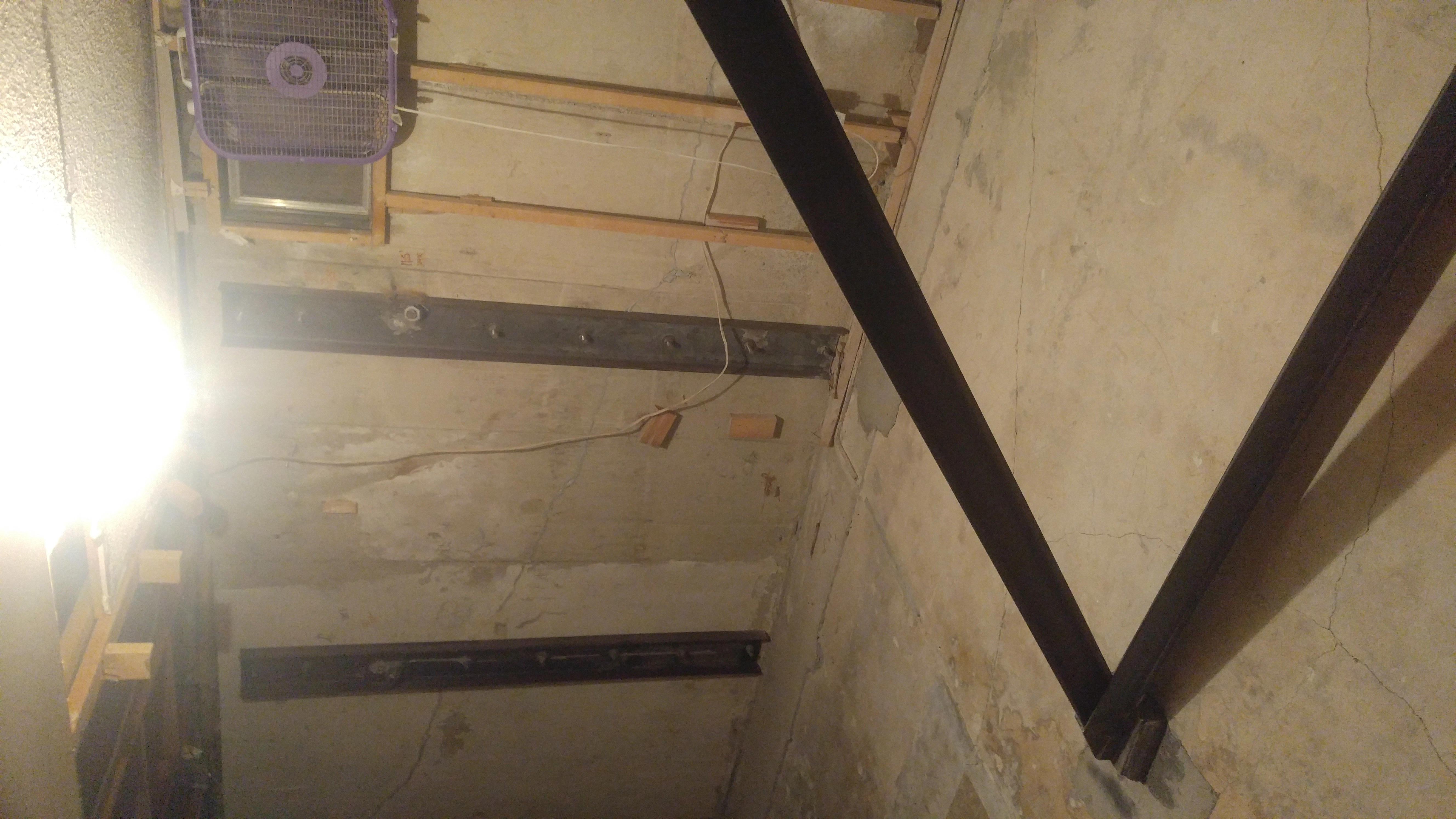

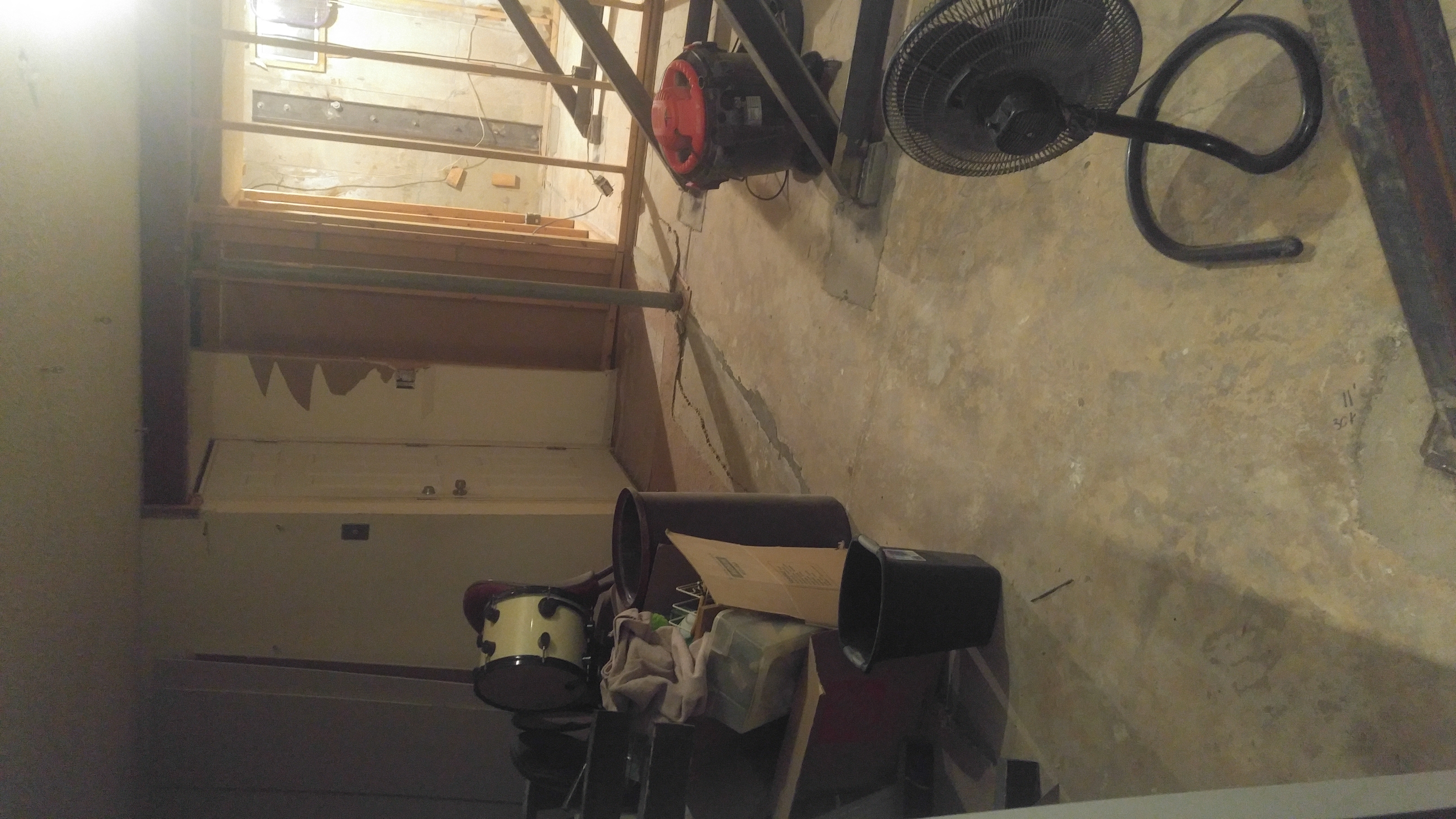

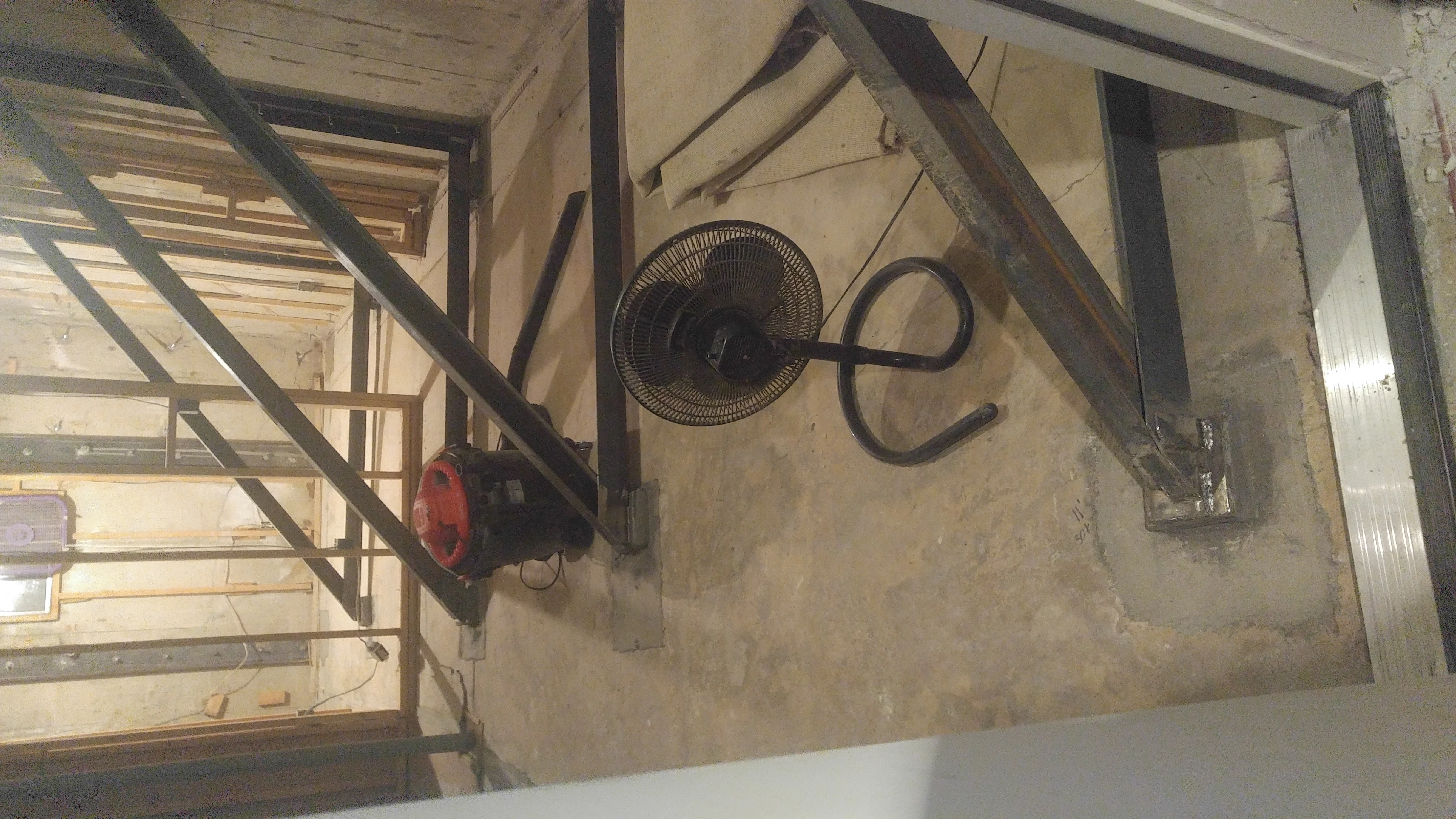

I'm attaching pix that show the intrusive 'counterforts' that had to be built to hold the North wall.
Initially I had my desk on the South end of the room that I show in the drawing the desk on the North side. Because the original space had two 'wings' at the North side, that was the best placement to keep centered in the space. But that had the impossible to move Drum Room door right in the corner. I had placed a moveable 7.7'x2'x4" bass trap panel there behind the desk. Pain in the ass. Now that I have lost space with the counterforts (angled 3"x4" steel beams and loss of the existing walls) I now am making better use of the room by setting up the desk on the North side where they are. The squiggly lines on the North side in my shitty drawing are the placement of those. Hope any of this makes sense. Maybe the pix will help. My desk and monitor stands will make best use of this space.
My 'Drum Room' already has rockwool in the ceiling. The 'Guitar Room' is already treated with rockwool and pink stuff. I already have 12 2'x4'x4" hang able panels and two 7.5'x2'x4" corner traps that can be placed anywhere. Side reflection points and such. I plan to stuff the ceiling above my new desk location so that I do not need a cloud hanging. I plan to cover most of the new treated walls and ceiling with cloth.
The pix will hopefully make that more clear as the purple box fan is in the window of the prospected 'Vocal Room' in each.
Pix loaded out of order. The third one shows where my desk will be placed. Between the fan and the vacuum will be my seating position. Just to the left of the center counterfort. My poor toes....I had them modify that one to give me 6"" more space so I don't break a toe. Oddly I am happy that I will have the access behind my gear to wire and fiddle with shit.

I think your plan is the best considering the space(s) you have to work with - symmetry in the mixing room and as big a 'live' room (drum room) makes the most sense.

So the drawing...is that what is all there now, or what you will end up with?
I was just trying to get a clear sense of what will all be your available space.
If the layout in your drawing is it, and that's what really works for you and that's the only way it can be...then I guess we don't need to even talk about the layout, and I assume you then are only asking about how best to treat the walls and such...?
Like I said...you've got a lot of studio space to work with, and when finished, it will be great...so don't stress about that.

Jimmy, you could put the mix space in what is now the drum room and set up the band across the space that is now the three isolation rooms, or have enough window between the isolation rooms that the band can see each other as they play. I think that is what I would think about doing.
