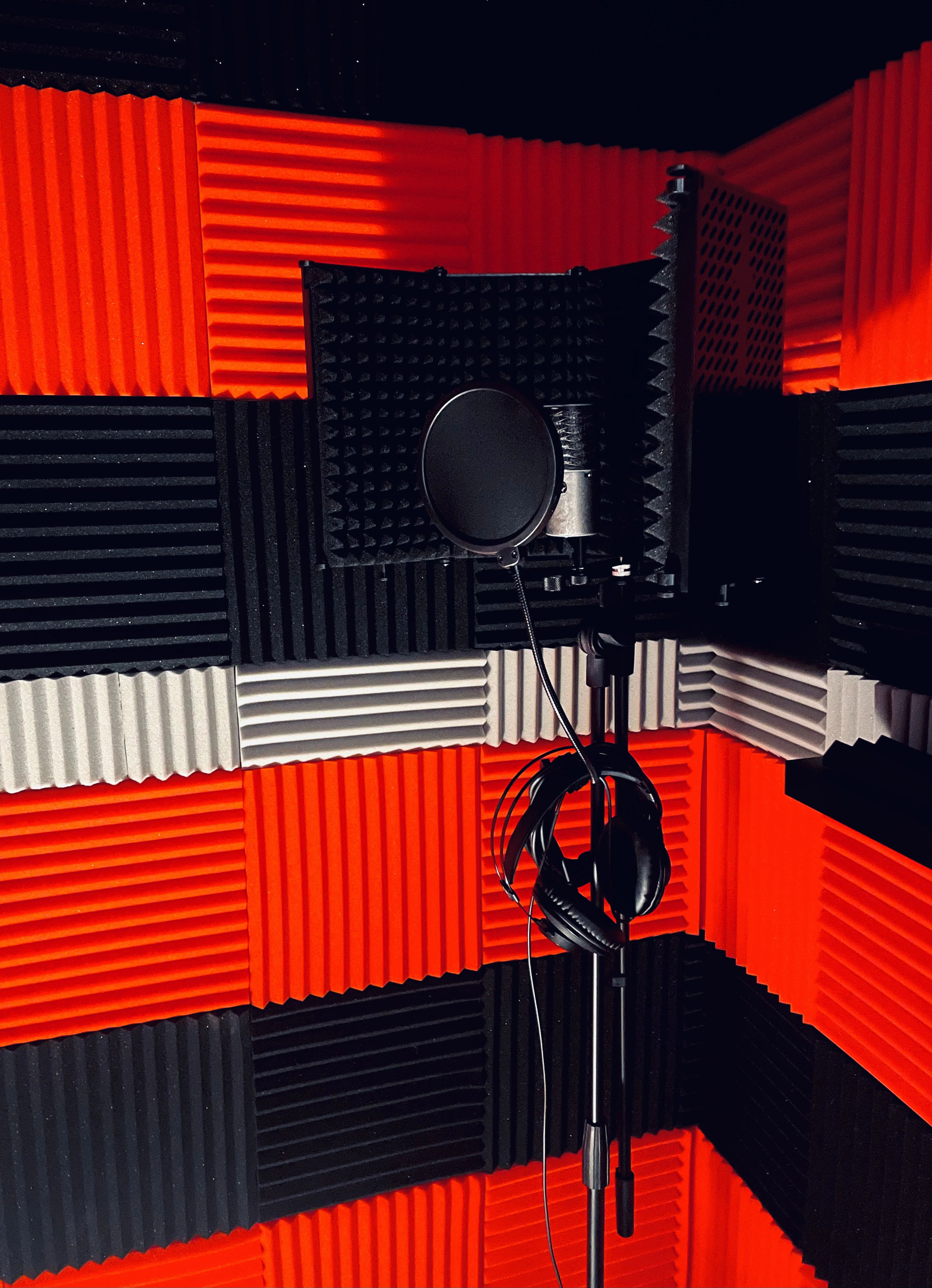

can you give a little more detail on your "soundproofing"? plywood and styrofoam aren't great indicators...and just because your ears can't hear it doesn't mean your mic won't.

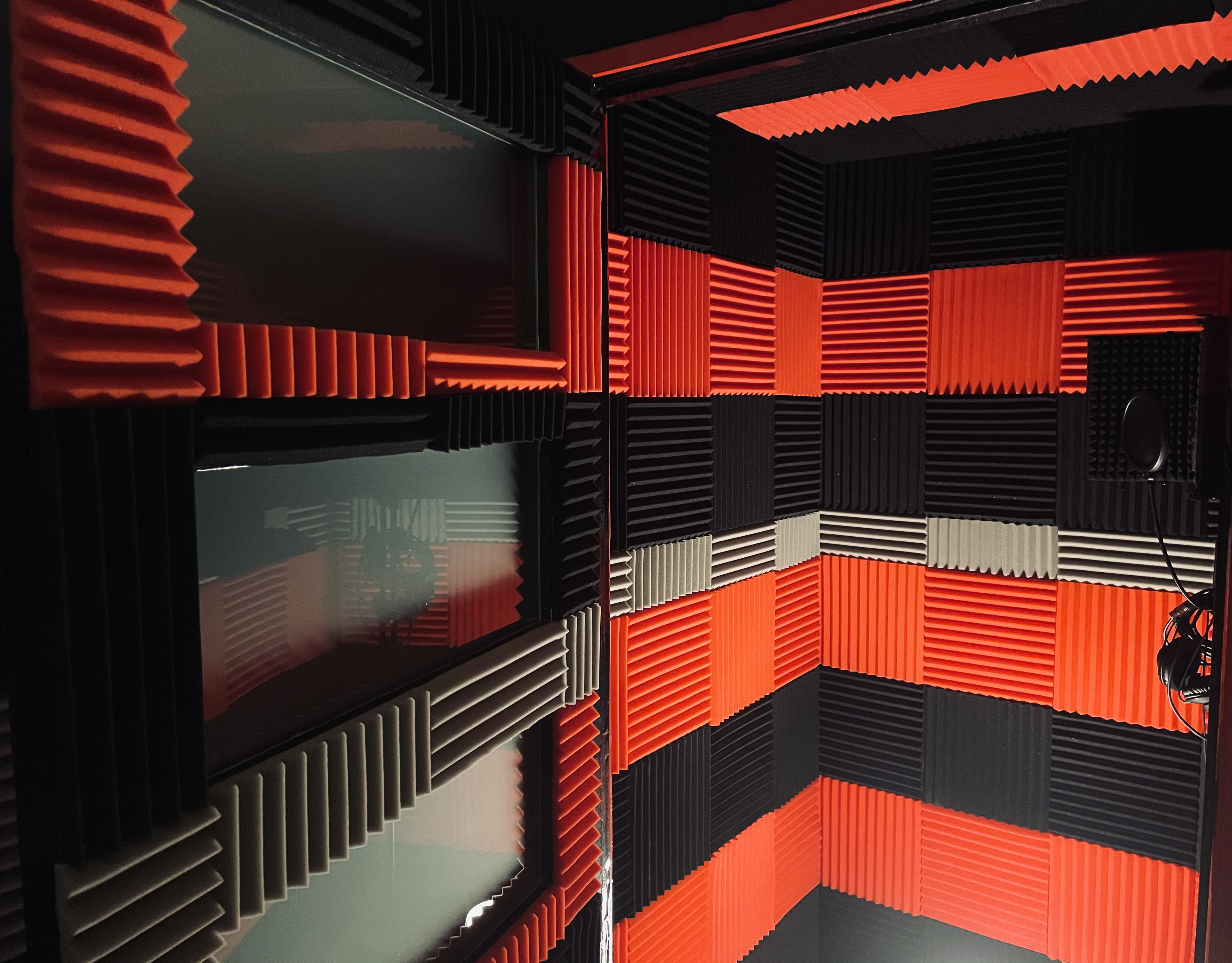

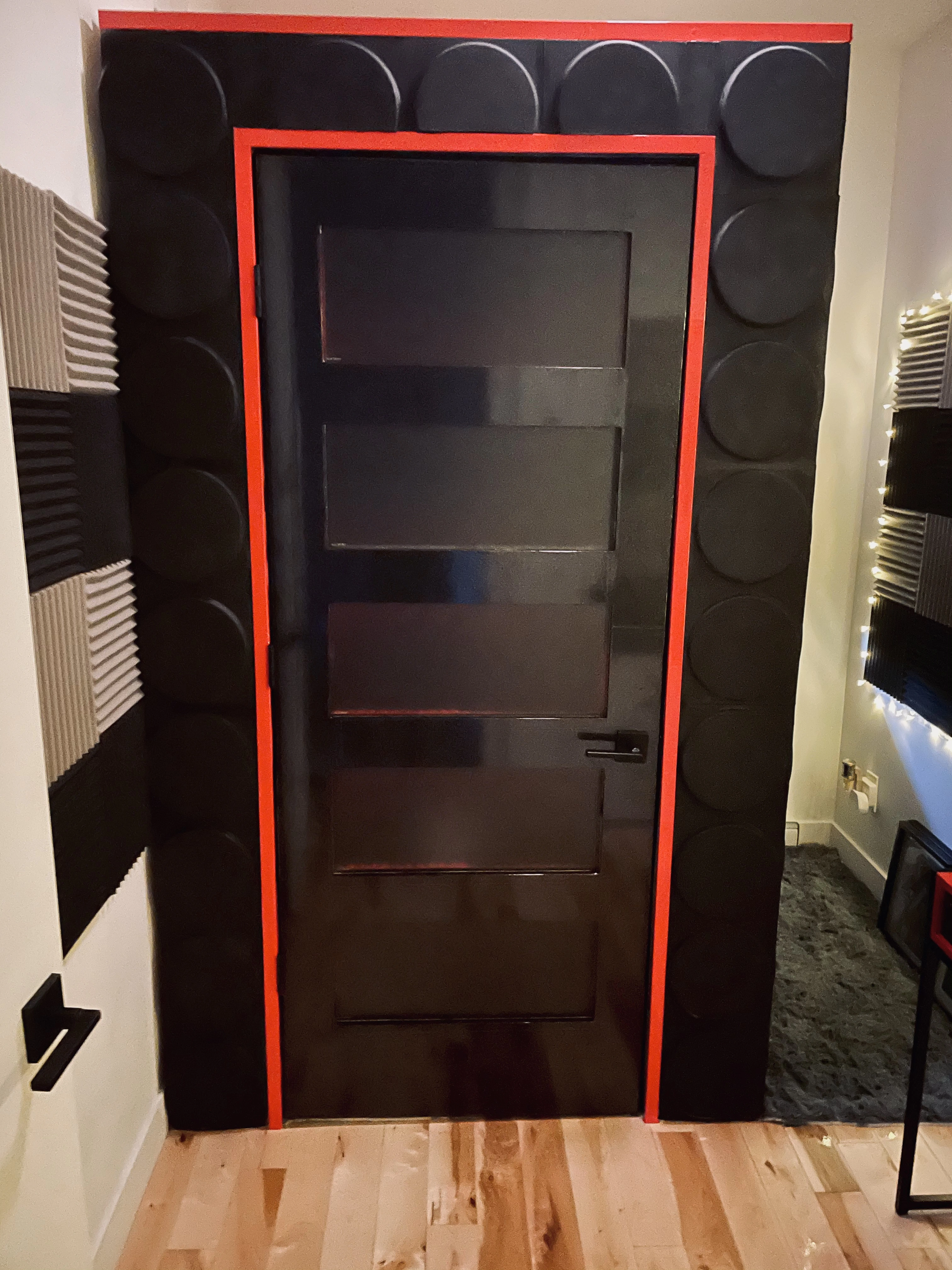

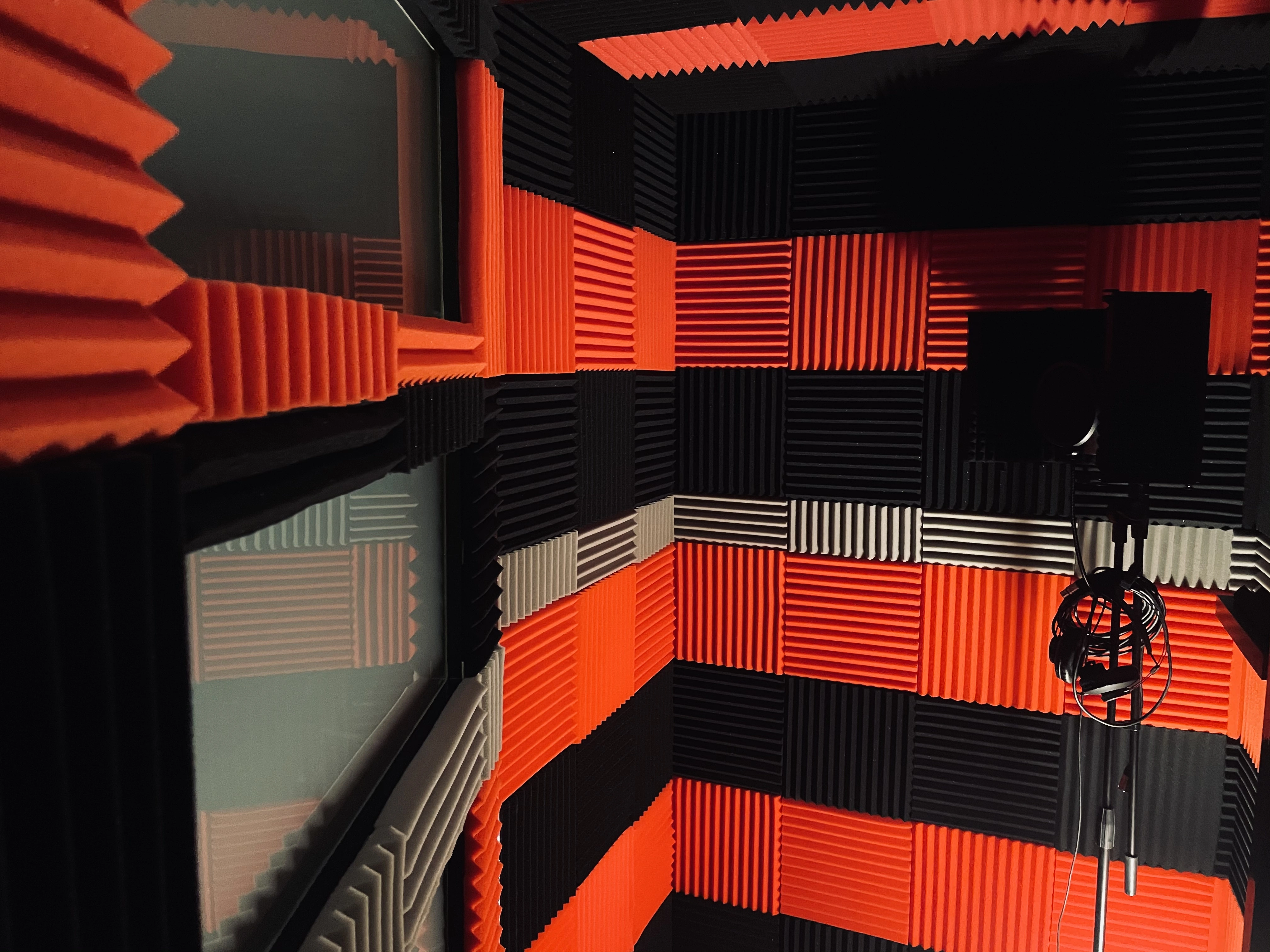

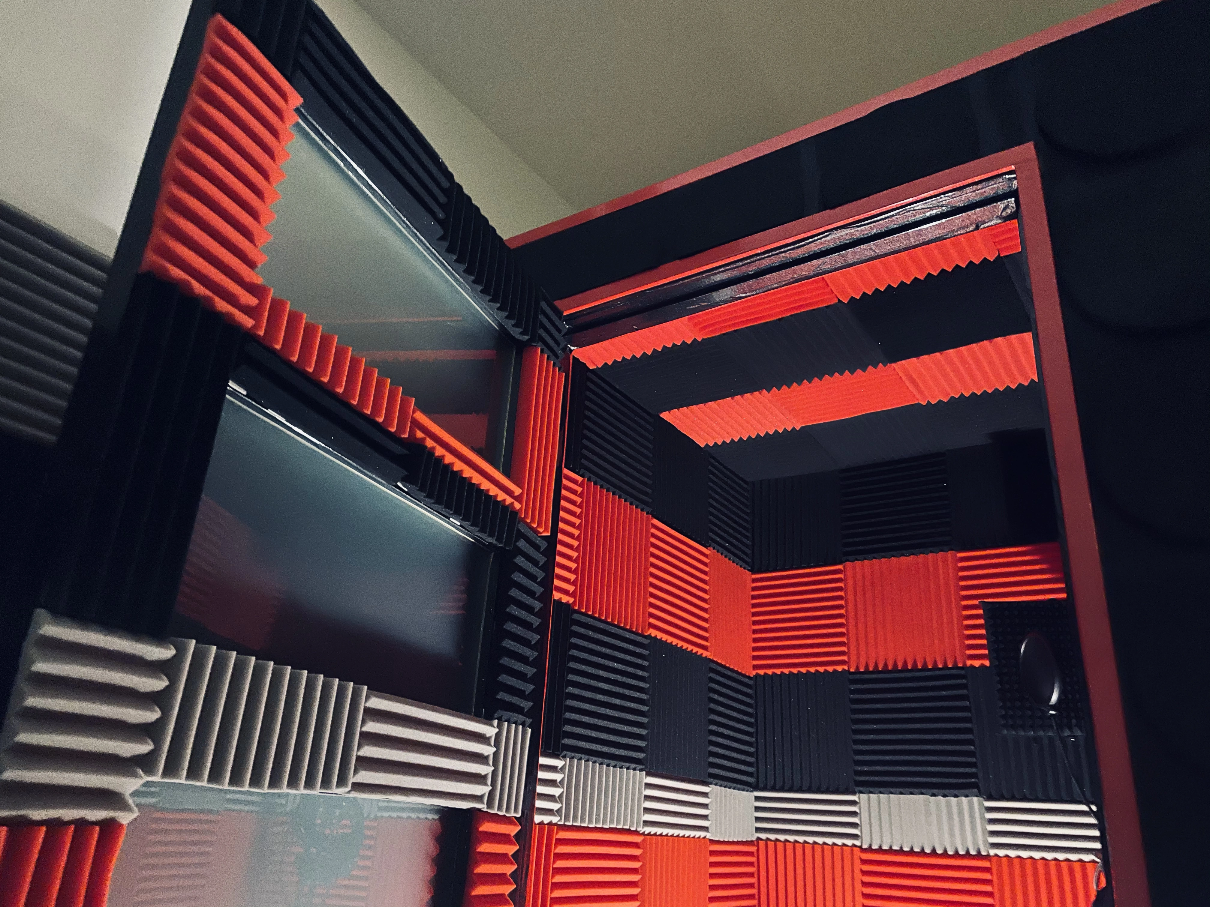

This is the booth

Lots of foam there but nothing that will keep sound out and no shock mount.
