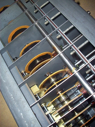

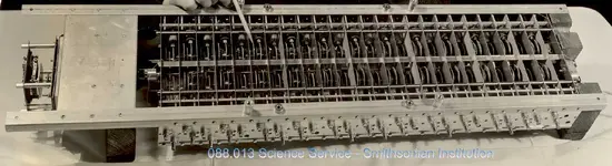

The tone wheel is a spinning axle with lots and lots of circular metal discs, and there's the motor that turns it....the oil keeps the metal lubricated, since it has to spin at the right speed all the time.
I didn't check the oil in mine for about a year and half....last winter when I fired it up one time, it was running for about 10 minutes, and then I heard a little grind. I quickly shut it of, opened it up, and dabbed a little oil along the entire axle at ever disc....filled the cups...let it sit for about an hour....then fired her up again, and quiet as a mouse.
Now I put a small label by the power button with the date of the last oiling, so I don't ever let it go that long again.
Ohhhh, epiphany. Thanks Miro. I knew organs used tonewheels, but that's far more complicated than I ever thought.
