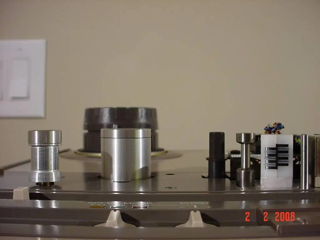

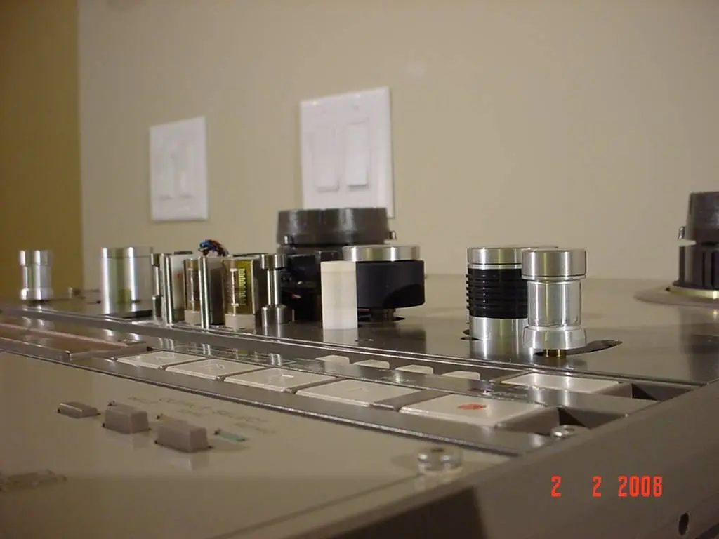

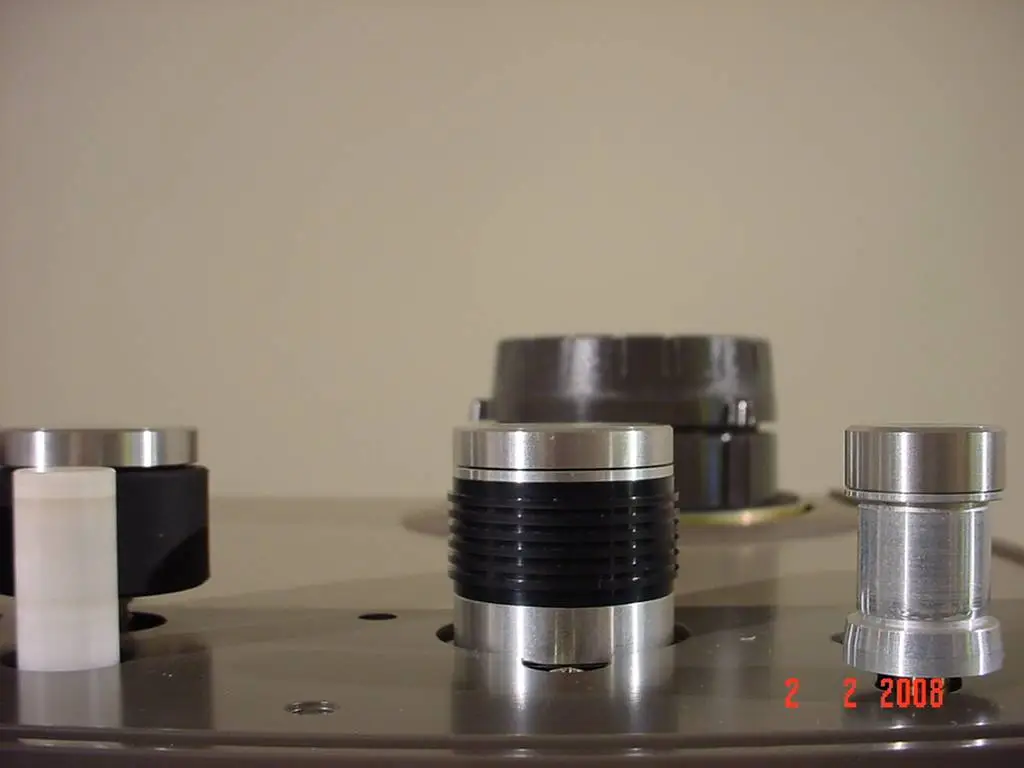

Well, I don't know if the 2 arms are slightly off or I'm being anal again or what..... but tell you what, I'll post a couple of picts and you'll decide if they're fine or not.:o
Let's see, where's my camera at.....:confused::eek:

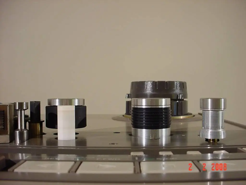

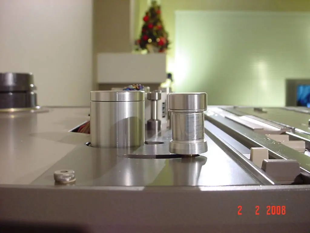

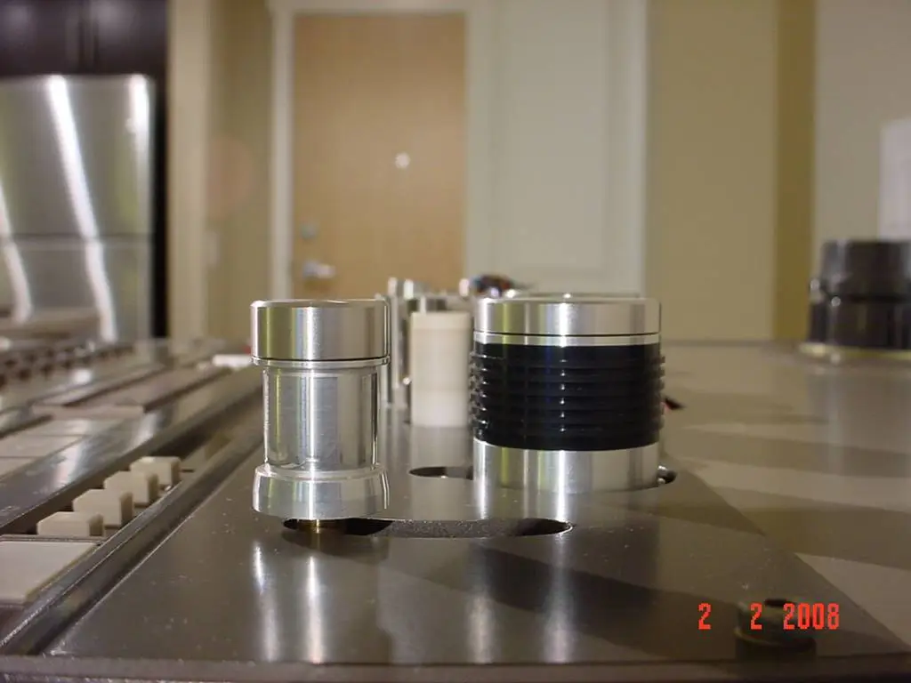

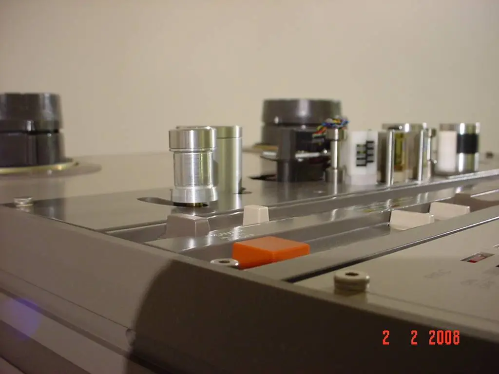

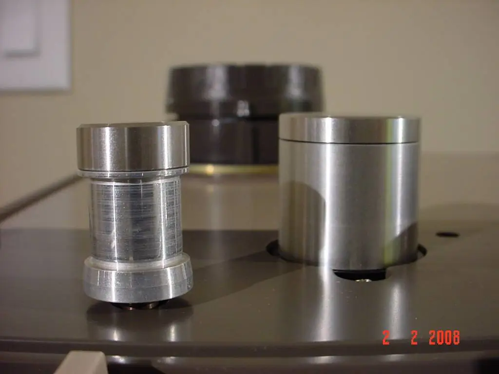

Jeff, here are some random photos (I don't want to influence you but the left arm especially looks a bit off):

I'd say it's bent, very slightly. You'd probably be okay to bend it back slightly.
An unwanted effect of a roller that's not in parallel to the tape path & other rollers would be to put uneven tension on the tape, which could possibly stretch or skew the tape in an uneven fashion across the width of the tape. That type of tape wear problem in the extreme case would probably cause noticeable flutter and phase problems between the left and the right tracks.:eek:;):eek:;)
Dave, you mean the left one? That's what I thought. It's like someone pulled up on it when lifting the machine or something .... I dunno .... Anyway, when you said bend it back, how exactly (and with what) do I do that?:confused:
Rule of thumb: Do it gently if at all.
The 7th picture in the sequence seems to be at an oblique enough angle to make it look off kilter. Yes, the left one.
Spec: You've determined with the naked eye that something's out of alignment, so you use the same technique to bring it back into alignment. You eyeball it.:eek:;)
Good luck.
OK, I get what you're saying but in actual mechanics of doing it, do I just g e n t l y (of course), pull on it, the roller, with my hand? No need to remove anything or use any other tools? Just gentle pressure, with my hand, to bend it back?
SUCCESS!!!:):):):)
Dave, I just did the above and it seemed to have helped! What a relief I don't have to dismount anything! Amazingly it didn't take much manual pressure to bend it back into a more uniform place. I can now see how easy it is to bend those tension arms. In your estimate, what is the actual structure in there that is the weak link and enables it to bend like that?

Hey those are really nice, clear photos, what type of camera did you use? Is it just me or in that one photo do you still have christmas decorations up?;)
Thanks for the kind comments.:) The camera used [wait for the drum roll:D]....... is........ a 1 mega pixel Sony DSC-P30! :eek: Yup, it's quite an oldie, made several years ago but I wouldn't upgrade it either. It has a nice macro setting as well as a manual over-ride mode and pretty cool night shot feature [which I used on those BTW with no flash]. I will tell you though, that it's technique rather than the camera [as with audio recording]. I've used this P30 for about 6 years and always figure out a way to get better picts. To give an example, I used the night mode on this, set the camera on something solid so that it wouldn't vibrate [also used a timer] and played around with focus (sometimes focusing on my hand where I wanted it sharp) and also the amount of light ........
......and yes, that indeed is a Christmas tree!:eek::D;)

The problem [was] with the left side mostly, as the tape leaves the reel and goes under and over the left tension arm. The tape was def not straight. The tension roller was not straight. [See especially the next to last photo - #7]. The right side is a lot better [although not perfect] and so is the tension roller arm. Yes, I'd say if you straighten those out, it'll solve the problem.
