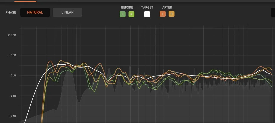

OK, here are my results set. It seems the chart is pretty self explanatory. I did a mix of an older song, but I am not sure I turned off the plugin before I rendered, so I need to verify before I post.
I only purchased the software and the mic. They have a box that can be used as an outboard EQ between the amp and the speakers. IK sent the mic and failed to provide the SN for the plugin, but they corrected that within an hour of me contacting tech support.
From the looks of it, the lower region of the room/speakers were the biggest improvements. The rest doesn't look horrible. $200 bucks, I can't say if it is a sugar pill or not, but I am going to believe :)
When taking the measurements, it gives you a choice, 7 points to measure or 21. Then it gives you the areas in which to measure, then it is a wizard type interface. After you are done, you bring the plugin into the master bus and have it as the last plugin. Mix your stuff, when done, turn off the plugin and render. If interested I will post a before and after song just as an example. The one nice thing in the plugin, it does give a better idea of the loudness. My original mix was pretty loud and I had to reduce the output.
If nothing else, at least I feel more confident I am hearing my music as good as my crappy room and speakers will allow.
