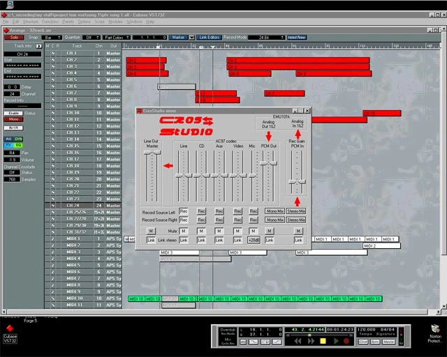

Are you sure you're using the latest drivers? You should have an input mixer screen that has a lot of red writing on it now. It looks quite a bit different than previous versions. If so, were you able to save output mixer configurations and then re-open them? I never have once; I always get a screen saying that the file can't be opened.
The routing scheme is just plain silly in my opinion. If you're just recording two audio tracks (stereo) than its no problem but if you want to overdub more tracks you have to route the output mixer through outputs 7&8 (is that at all logical?) and then set the input to the output mixer (yet another confusing thing to even describe) to record on tracks 1&2 and have them set to "direct to disk". For some reason after you do this the first thing you'll notice is that the input signal is now incredibly loud compared to the way it was when you recorded the first two tracks even though you haven't touched a thing on the input mixer. After you bring the input fader way down, the next thing you should notice (at least I did) is that the sound coming into your soundcard just isn't the same anymore. It's close but a little odd. Kinda like listening to an mp3 compared to a wave file, the way an mp3 has that swirly high-end thing going a little. Admittedly it's not horrible or even close to it but it sure isn't as good sounding as the original setting without using that "direct to disk" stuff. I have no idea why this deteriorates the sound but it does.
