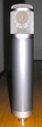

Oh, and I painted the body so it doesn't say "Apex" anymore...
... 'cause it AIN'T!!!!

Nah, I'm still around. What capsule did you use? Post of pic of the painted body, I'd love to see that. What do you like for paint?

Well, I started out using a capsule from a CAD E-350, which was good but I wanted to save it for another project. I later swapped for another double sided capsule I had in another mic. I believe it's a 797 capsule. I may go back to the CAD capsule and see if it's better or not.

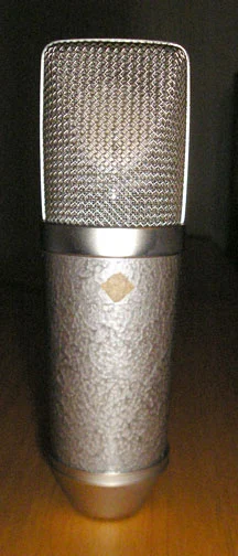

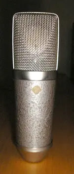

The paint I used was a grey hammered finish, but I sprayed it light and in few coats, so it doesn't loook hammered. I've attached a pick of a Nady TCM1100 I modified which has a beige hammered finish that looks pretty vintage. Pardon the diamond. It looks like crap and I'm going to remove it. I was just testing what it might look like with a badge. I may try that beige hammered paint on the Apex.

That former-460 is looking sa-weet with that paint job. Capsule looks like a 797 with the white retainer ring.
