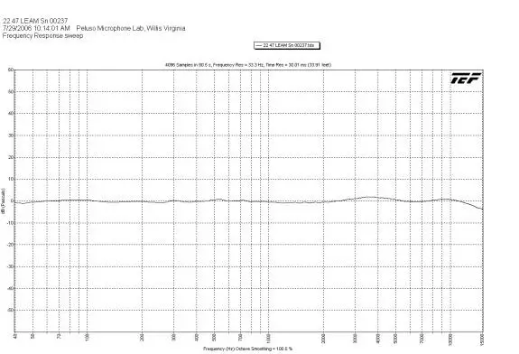

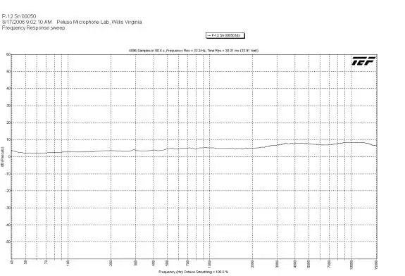

The CEK-367 is actually supposed to be similar to a U67 capsule. The CEK-89 is physically smaller any my guess is that it's similar to a U89 capsule.
The CEK-367 has that Neumann type sound. Warmer mids.
The CEK-12 is roughly similar to a 414 but with scooped mids and a presence hump. I previously posted links to some audio files that had the CEK-12 capsule against the stock capsule, which is more similar to the CEK-89 capsule.

The CEK-367 and CEK-89 are both based on the U67 capsule, but one is smaller. They use the same in-line grid vent hole pattern with the same spacing, the CEK-367 is just .1" larger.
The U47 (UK47) has a radial vent pattern, which has a different effect on the sound. Much more like an M7 capsue would sound.
The CEK-12 is pretty close to a C12 capsule, but the plate depths are bigger, and I don't know if John adds the 40 micron resonance chamber known to exist in the C12 capsule. That probably makes the sound different but similar to a real C12.

I got these curves from kind John Peluso.
