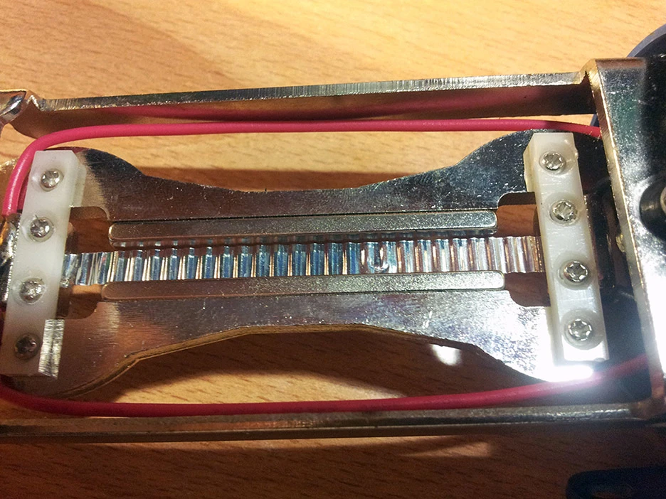

I decided to check this thing for ribbon sag.....not that the sound I was getting from it led me to believe it was sagging but I wanted to make sure. So I took the screws out and took it apart and was very careful about how I was handling it.
They say it's an easy mod to remove the shields on either side of the ribbon motor...and it is technically speaking. But let me warn anyone thinking about doing it that the the little nuts on either side don;t exactly want to unscrew too well from the posts. They unscrew good for a little bit...but towards the top of the posts..they get stuck and won't turn.
This is where I ran into trouble. I was forced to get heavy handed with these nuts (man it gives me shivers saying that...haha) because otherwise I would have never been able to put it back together.
In my struggle to get this apart to take the shields off....I didn't noticed that one of the small nuts that manage to removed have slipped down into a small crack on the surface I was working on. The magnet grabbed it and sucked it right into the middle of the motor where the ribbon is.
It didn't tear the ribbon (which I'm shocked it didn't)...it just caused it to majorly sag...and it dented one of the corrugations. After I got the nut out...I had no choice but to re-tension the ribbon.
I managed to do it...but in order to get it back in the middle with no sag...I had to pull the ribbon out about 3/8 inch. This caused the ribbon to flatten out a bit and losing it's amount of corrugation. Also one of the corrugation peaks has a slight dent on it. I honestly thot I had ruined this mic I just got.
Anyways...I put it back together and plugged it in...and it still worked. I recorded some audio of me just talking gibberish to compare it to the sound of the audio I had recorded previously.
It's sounds like it's ok...but I need an expert opinion on this. So my question is....by flattening out the ribbon as I described (it's not totally flat..but the peaks and valleys in the corrugation are about half the height they were)...and with the little dent in it...am I losing sound quality? The ribbon isn't touching the magnets by the way.
