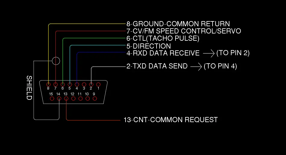

Hah! I have finally achieved full lock synchronisation! :D
The problem was this: the ATS-500 manual is full of lies. The pinout is WRONG and does not carry the servo control line, so obviously it isn't going to work properly.
I rebuilt the cables according to this spec which I found by accident:
https://homerecording.com/bbs/showpost.php?p=1110368&postcount=5
..and it now works like a charm! I guess I can rerecord some of my songs to take advantage of this - the benefit being that I can lay down the new tracks on the slave and simply mute the old ones.
Okd thread here I know but does anyone have the ATS500 correct pin out diagram the above link doesn’t work. Thanks
I believe this was it:
There were two cables. PW-88M, (Master), and PW-88S, (Slave).
