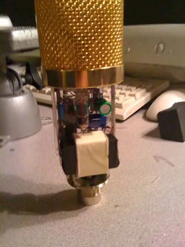

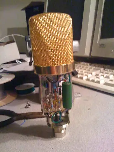

More pics.
Of course, I have no idea how it will sound compared to a CS series. (trying to stay on topic)

wow-- what kind of capsule is that in z's mic? is that a 6205 tube again? edcor transformer?

Its a Dale Ulan M7. The tube is indeed a 6205. The X-former is a Cinemag. I have the laminations insulated because they sit so close to open parts of the circuit.

The one you're looking at is one I built from a Soundelux e47 frame I had. There was no sleeve, so I had one (actually 3) machined. The machinist and I were talking about doing all the parts and making a small batch. It's expensive to have all the parts cut. I may do all the future stuff with Marik. This guy had already started when Marik and I were talking about it, so I had to finish with this guy.

That is awesome and I am jealous Z. I've seen those Dale M7 threads on DIY and wished I had the mic making skillz. :(

Nice-- I remember that whole Soundelux deal. I was hoping it was a prototype for a PhilGood production mic :)
