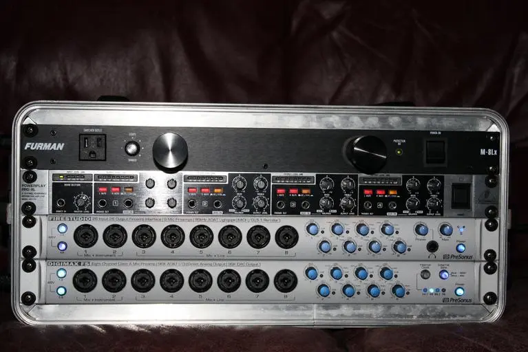

I started with one Firepod and had no problems with it. Then I got another Firepod and didn't have any problems with them. I had them daisy chained for 16 inputs. As a note: I bought both Firepods used. I then sold both of the Firepods (not because I didn't like them) and bought a Firestudio and a Digimax FS to replace the Firepods. I have been exremely happy with all of my Presonus gear. I haven't had any problems with the Firepods or Firestudio.
I've got the Firestudio and Digimax racked up in a 4 space rack with a headphone amp and a power conditioner. It makes for a very easy live recording rig. See pic below.
The only thing that I kindof don't like (and it's a very small dislike) is that I find it a little confusing to assign in/outs in the Control Console software. Maybe it's just because I haven't used it enough.
The installation was a snap. And like I've said, I've had no problems with any of my Presonus gear.
I was really, really close to buying a StudioLive last Christmas, but I backed out. I REALLY like those things. It's a very cool piece of gear.
