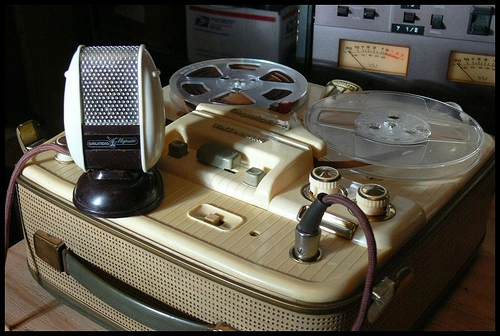

This is a good sounding MIC - Grundig, Telefunken branded AKG, but there is a lot to choose from;
Vintage 1953 Bakelite "Telefunken" AKG D11 microphone (in use) - YouTube

In my case, in combination with that tube Telefunken, I don't think I've recorded anything so "Gorgeous" sounding. Presence and Musicality. I only have one other DIN MIC - a Tandberg TM-4. It is pretty good, but my Grundig is engaging.

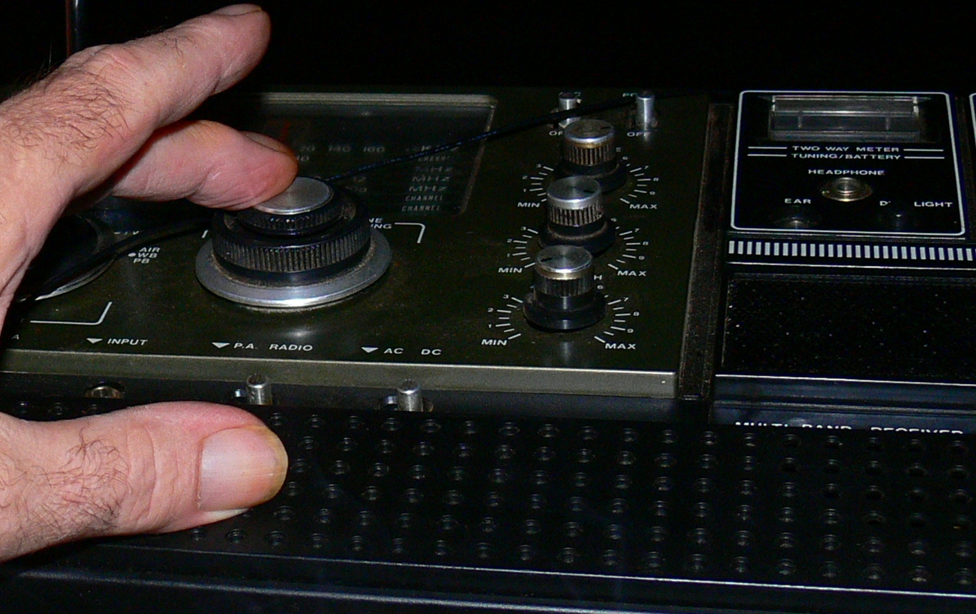

As an aside, regular radio drift can be pretty cool. More Radio Turkey. I have older and newer SW, but this one is so in the Aeather
