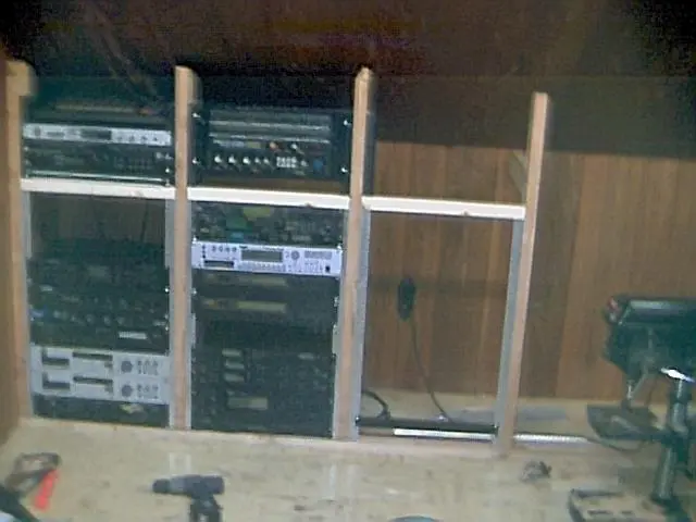

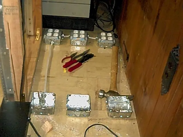

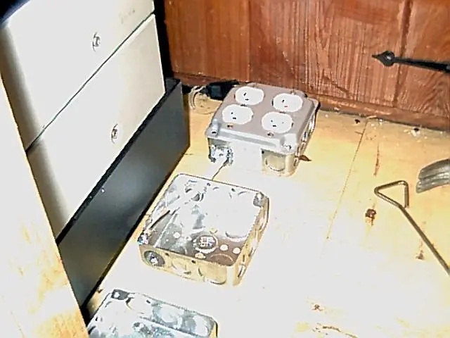

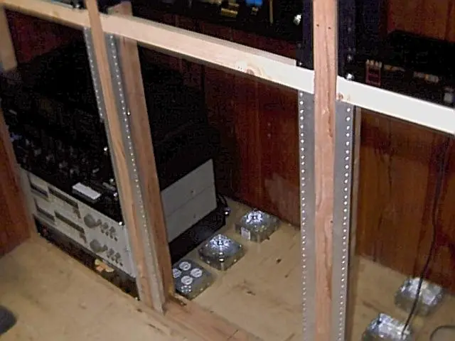

Anyway, the temporary "in progress" circuits give me 15A for the worklights, halogens and the two computers, and another 15A for all the audio gear, on two breakers.
The final allocations will be:
15A computers & 10/100 switch.
15A periperal outlets, lighting and such.
15A mixing consoles & recorders.
15A for all the rack gear.
