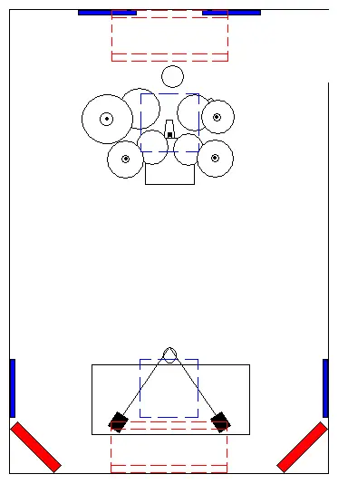

So I've got this 11 x 16 room that I'll be using as my home studio from now on. The desk obviously will be centered along one 11 foot wall. The southwest corner is nonexistant, as there is an entryway there instead (no door).
I have 4 self-made bass traps, and 6 Gik traps (2x2 foot each). I've read and read and read, and I'm pretty sure that I know where to place them to get the most use, but I tend to want to double-check here because a lot of times my notions are WRONG. Where should I place them?

I was planning on putting one up directly behind the desk, one up behind the drum kit (at the opposite end of the room), and then 2 across (turned diamond-style) on each of the long walls, starting directly parallel to the front of the kit.
Nobody? Here's a really tragically rough sketch of how I figured it. Bass traps in red and Gik traps in blue.
I know, I know, I did a fabulous job on the drums there... :cool:
Turn the room so you can trap both the corners in front of the mix position and have better symmetry for mixing.
1 panel directly behind each monitor.
1 panel on each side wall for reflections when mixing.
The rest on the ceiling over the drums - and you'll need more.

I'd use 2 of your traps in floor-ceiling corners, and then use the other 2 in wall-ceiling.
So more like this? Gik traps are still in blue, bass traps in red, with the ones that would be attached or partially attached to the ceiling as hollow squares.
Like this...

Shit, that looks nice. Thanks for the help!
You're killing me, though, with this insistence about putting the drums by the entryway. The wife will NOT be pleased.
Sorry but you wanted the best answer. What Panda drew is exactly how I would lay out out at this point. Nobody says you have to have the drum kit all the way at the other end. Put it more toward the middle. That'll also kill the quick slap off the walls when you're that close.
