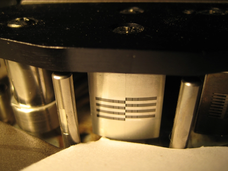

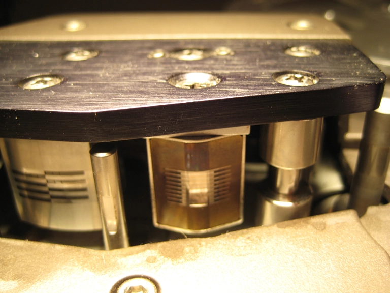

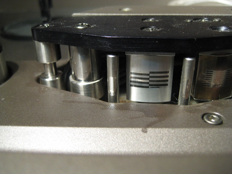

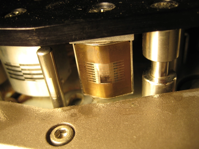

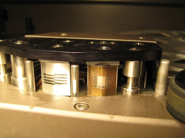

how do these heads look to you?
anything I should watch out for in picking up a used 388 with ostensibly no issues for $800? any components easy to check on that commonly fail and prove expensive or difficult to repair?
I have done my research, just trying to get input from knowledgeable people before I make a huge investment into this machine! I am experienced in the ways of cassette multitrack recording and I am really excited to upgrade to a machine with a little more headroom and punch. thank you. IMG_5005.webpIMG_5006.webpIMG_5008.webpIMG_5009.webpIMG_5010.webpIMG_5011.webp
Very Very Very badly worn R/P head.Lifters are also worn which will cause tape edge damage-it's a boat anchor unless you can find a R/P head assy. and lifters assy.I know Tascam Parts does not have heads for that model-don't know about the lifters though...

The heads have some miles on them. They have wear but not terribly worn. The lifters will generally show more wear because the metal is softer on those and a machine gets a lot more FFWD and RWND action than play/record action. The heads could be relapped, but it's very difficult to give a full evaluation by photos alone. It may all be a moot point however because $800.00 is just too much for a 388. There are still 388's out there in better condition for less.
I'm with Beck.
The lifters show higher than average miles, R/P stack looks consistent with that.
Still life left, but not what I'd pay $800 for.
Like implied above this is all "grain of salt" stuff because its impossible to give a head report off of a picture but I think you're getting the...erm...picture. :)
I had a 388 stack relapped and the 388 stack has a relatively healthy amount of tip-depth when new (i.e. there's a good amount of "meat" to work with when relapping) so that's good, but there's no way to get even an estimation on remaining tip-depth on that type of headstack without sending it to JRF, Sprague or similar for an evaluation.
Might be able to get new lifters from Teac, or put sleeves on those ones...or turn them but that's not easy.

To my eyes the lifters are more important to replace that the R/P head. The head could be relapped without to much of a problem.
