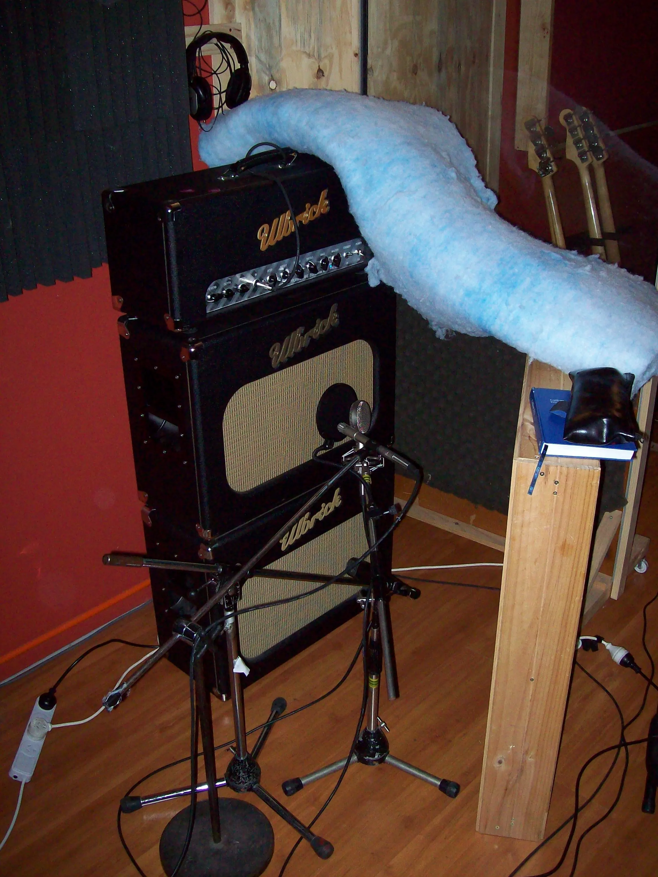

I recorded a loud guitar cab once and posed a pic here to show the setup for the how to mic a cab topic, I got a bit of flack about placing a pop shield (vocal type) in front of the ribbon to stop it getting bursts of air and distorting the ribbon, it works.
