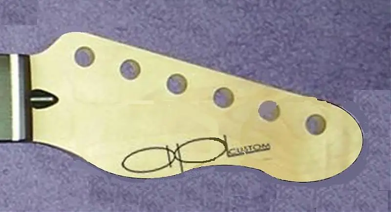

Hey, Light, I support your position on straightening the fingerboad before leveling the frets.
Behold, the birth of apl CUSTOM Gutairs!

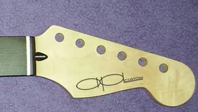

Here's the uniquely identifiable apl CUSTOM Guitars headstock shape for apl CUSTOM Guitars.

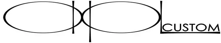

Here's logo, version 2.
