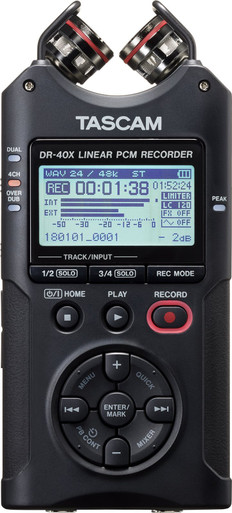

If a stand alone to SDCard is really preferred then the Tascam range is very good. We, son and I have the DR 40X (I think, will check) which can record using attached mics or/and two XLR/TRS inputs. N.B. that recorder does not come with any media, i.e. no card.
