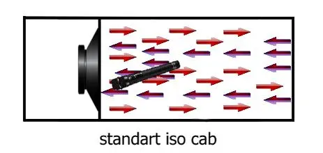

As we all know iso cabs tend to sound boxy because of the wave jams going on inside the box. The waves coming out of the speaker hit the wall in front and they are reflected back to the speaker and this is just a neverending cycle which is causing boxiness in the recorded sound. Something like this:

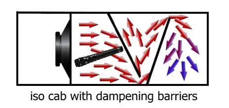

My theory is that with a setup like in the below illustration, it could be possible to trap the sound in a separate area in the iso cab and let it dampen there without being able to hit back to the speaker.
As you can see above there are two inclined traps in the iso cab. First one has a slight gap at the bottom and the second one has a slight gap at the top. They drive the waves to the dampening area and the waves dampen there without being able to escape back.
I am not saying that no wave would be reflected from the first trap but it would be much less than a standart iso cab reflection.
What do you think? Worth trying? Or it just makes sense in theory but wouldn't work practically?
You need to research speaker cabinet design--paying attention to ports--to learn what the effect of your design would be. It isn't quite what you think.
You mean there is need for ports to make this work? Then that would not be an iso cab because of the leakage. Wrong?
I think he means that those gaps you have in the interior baffles ARE ports. Just because they're inside doesn't mean they won't affect the sound and will likely be tuning those compartments. So you might help with the standing waves but cause a problem somewhere else.
I'm not saying it's not worth trying but the size and positions of those ports is gonna be a factor in how the cab sounds just as much as the standing waves you're trying to eliminate.
Let's think about this on a macro scale, instead of a box you have a room which is the first chamber of your box. The slot at the bottom is a window. If you open a window, do you decrease the standing waves in your room? Yes you do, a little.
Now, remove an entire wall of your room and open it to the outdoors. The standing waves just decreased a LOT.
OK, let's shrink it--go into a closet and close the door. Now open the door to your room just a little bit. Did the response of a closet improve with the door open a little? Yes, a little. Now open the door all the way. Which is better?
using that scenario ....... wouldn't you also decrease standing waves by angling one of the walls ?
Sure, that's what opening the closet door a little does. But isn't it better to open it all the way, or just take it off its hinges?
Whenever you build an iso box, you're really building a speaker design. You have the consider the effect of the box (front and rear) not only on standing waves, but also on the response of the driver. An iso box probably isn't going to sound like an open-back cabinet unless the box is really big.

I agree with what he is saying, but note something about his design: it's vented to the exterior. I didn't look for his drawings, but I imagine he's done a transmission line design (what he calls a labyrinth) or something similar. That's a well-described method of speaker design.
If you don't vent the design you'll improve FR at some frequencies and make it worse at others, which is also the same thing that will happen if you take a wild guess at the TL design.
There are important differences in your design vs. his. Yours has about 1/3 of its volume behind the speaker, as a sealed enclosure for the speaker. The problem is as the volume of the iso box becomes smaller in comparison with the volume of the enclosure, you can't treat the iso box as arbitrarily large in terms of the sealed enclosure design.
Next, I think he has devoted the bulk of his available space to his first chamber and taken care to make all surfaces nonparallel and angled out from the speaker until the far wall (the top I think). Your chambers are roughly equal in size, and by your drawing you have at least 3 out of 6 walls in the first chamber parallel/perpendicular (5 out of 6 if you don't flare the sides). He follows up with what seems to be a transmission line/folded horn/whatever you want to call (it's not really either, but is related to both) it running down the back and bottom of the cabinet, and then vented. Google an image of the guts of a transmission line speaker and you'll see something like what he did, and note how that differs from your design.
It wouldn't leak as much sound as you'd think because he also would employ massive amounts of absorption on the way, and the interior walls look to be pretty thick plywood. Put your ear next to a port of a typical speaker; all you hear is muffled bass and that speaker wouldn't employ the same degree of interior absorption. The purpose of the port is to control interior pressure, not so much radiate sound.
The devil is in the details . . .
