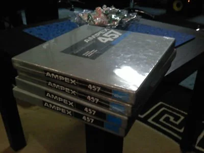

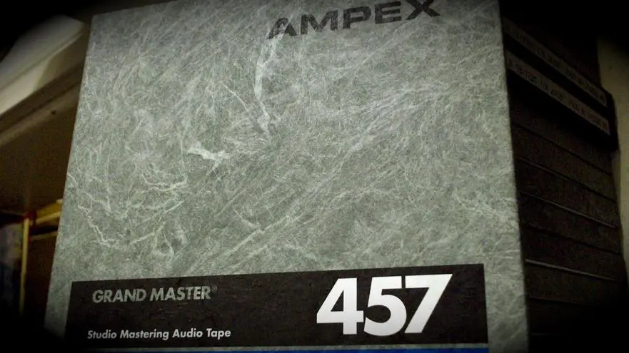

Check these out: (images culled from the internet)
If you're confident the right tape is in the right box:
Bad:
Maybe good if 1995
Most likely good (prob made by Quantegy using Ampex brand name)

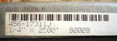

If you bought your tapes new and know each tape is on the original reel with the original box all you have to do is look at the date on the small white label. See attached photo of label with the date code. The string of numbers to the right, 92028, is the date code. Most important thing to remember is the first two numbers tell the year. So this tape in this example was made in 1992, which is bad. From year 2000 and on the year had four digits instead of two.
Also study the photos of the boxes posted by Blue Jinn.
Testing Ampex backcoated audiotape tape is not necessary if you know the date of manufacture. If it says 95 and later it’s good. If not then it’s not good. Actually the last quarter or so of tape made in 1994 is good too, but since it seems to cause confusion I’ve stopped recommending anything made before 1995 to make it easier.
