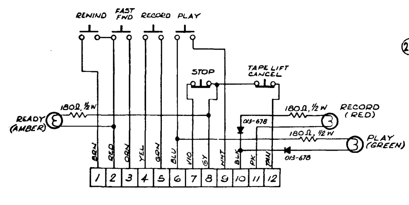

I've got a question about remote wiring for 440-c models. Or possibly a machine setting.
Here's my problem: all buttons work on the remote except for play and record. Nothing happens when I press record, which is normal. When I press play the BIAS lights up on the machine. Even though the preamps are in the READY mode.
Anyone has any ideas before I start tweaking with the wires?
I got this remote separately but was told it's stock.
