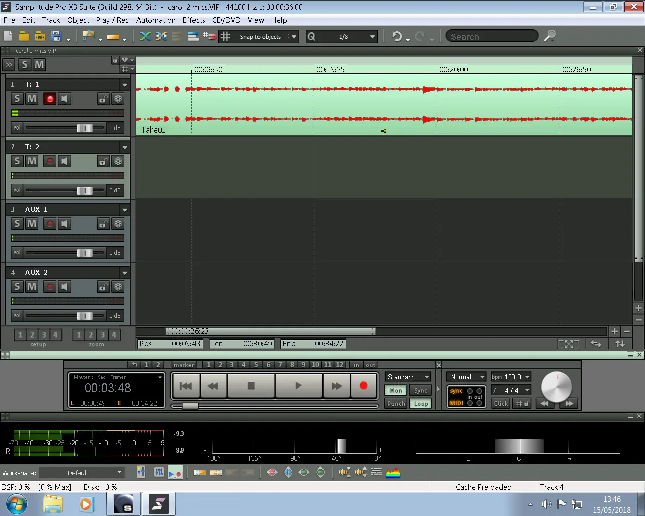

The setup:
Two mics strapped together, £25 dynamic form Maplins (I have donated my SM57 to my son's musical works in France! I know from previous tests that this mic is about 6dB more sensitive than a 57) The other is an AKG Perception 150 set for max sensitivity. I know left from right. Yous all must guess! Both mics are touching the cab fret just off centre of the Greenback, a 55Hz jobbie.
The amplifier I shall also leave unsaid for now.
Mics feed a KA6 the cap' channel is at zero gain and the dymo at 2 0'clock. The clip is being played out of a 2496 card to the amp.
The levels can be seen attached and in fact average around -13dBFS with a 'clang' at -9.5dBFS max. Thus, those with a 57 should not have any problem as levels will be about -19dBFS for the same gain setting and there is gain in hand. A Maplin N33GJ C weighted SPL meter was put against the fret next to the mics and recorded ~102dBC. Out in the room it was set some 1.5mtrs from the centre of the cab 1mtr in the air pointed straight up on a camera stand and read ~85dBC.

I preferred the right channel, but they sounded quite good together (split then panned center in Audacity). I'm going to guess right was the AKG, but I have no basis for that other than name bias probably. The left I'd have considered a bit muddy by itself, but either would have been workable.

I had to post what I did a bit swiftly and then got "Backend fetch failed" whatever TF that is! My main reason for the post was that new peeps seem forever to be having topology problems with their undergarments with levels, gain, noise and DAW signal displays! I hope this offering ties all those things together? I am saying.."Make THIS much noise in a room, stick almost any microphone against the cab and you will get MORE than workable levels with any AI (the KA6 has about 55dB of gain). If you don't, something is wrong and the "system" needs to be gone through in a 'systematic' way.
Ok, noobs will not likely have an SPL meter to hand (but DO get one as soon as your are able. $15, C weighted, easily good enough) so how loud was the amp? My wife was in the next room watching telly, separated by a single wood panelled door. She could hear the amp but was not distracted by it.

The right hand mic was the crap dymo, so crap I think that I shall rig another test with my shiny new Prodipe TT1.
No one had a stab at the amp? Thought some of you might GUESS it was a Blackstar! HT-20 (EL34, FIXED and cathode bias. Some solid state bits in the signal path) Driving, as I said, a Greenback in a modified HiWatt combo cab (W570 H450 D270mm)

The mics were "stacked" James, one above the other on about a 25mm centre so the were both in the same vertical plane of the cone. The dymo just sounded 'dull' to me.
The exercise was not intended to give a definitive 'super tone', more to show the sort of levels you get in a DAW for a known SPL at the cone and in the room.....SO many people seem to get in mess with this?

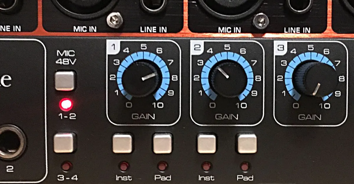

At the risk of putting this onto a parallel set of rails, but perhaps going in a similar direction as the original, I plugged in the electric (first time since last July maybe) and tried to make my fingers stay on the strings for a few minutes.
One dynamic and one small, side address condenser, placed as near as possibly in the same location on opposite sides of the cone, about an inch and a smidge in from the edge, and an inch or so off the grill. Recorded in Audacity. There's no test here, because the picture will tell the tale if nothing else.
First, it was set pretty low volume, measuring on my "super accurate" phone app about 100-102dB a couple inches in front of the speaker, and pushing 90 where I was sitting. Just adjusted the gains until the interface LEDs looked to be bouncing around the same and the waveforms (quite visible) in Audacity looked as close as possible. Now, while I had to push the dynamic gain quite a bit higher, it was still below where I'd feel like I needed to go looking for a preamp. (And, realistically, the amp was practically quiet compared to most electric guitar recording.)
Recorded as stereo, but if I wanted to use this idea, I'd probably just mix these mono, or maybe with a little pan. The clear takeaway, both in listening (split to mono in Audacity to compare best IMO) is that the dynamic has a little bit of natural compression, and even though the distances were the same, a lot more proximity effect. Enough that I won't ever put it that close to the grill again.
The condenser peaks about -7dB and dynamic about -9, but the integrated LUFS for the dynamic is 0.3dB louder than the condenser. It had few dB more low rumble at the end but I think that was just the proximity effect, and not really more noise. The setup wasn't going to prevent that as the amp and both mics on short stands were on the same table!
