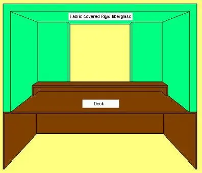

Read and find out. It is necessary if you want a great sounding result, but if it's just for you, friends and family to listen to then not really. You want you mixing position to be in the centre of one wall of your room, and on the opposite wall(the wall behind you)you want to totally deaden with material covered rigid fiberglass, in the corners of the room you will want to construct bass traps, and at the first reflection point from your speakers, ie. the walls to each side and the ceiling above your mixing position, you want to construct broadband absorbers. This treatment will allow you to accurately hear what is going on in your mix. Most rooms are bad mixing environments, and these absorbers will allow you to turn a bad mixing room into an adequate one. Where will you be mixing and what are the sizes of the rooms. Wait a minture, didn't i talk to you before? I would check you past posts, but i really gotta go to bed, it just after midnight and i have college in the morning.
Ohh, by the way, if you have a large room, instead of treating the whole thing you could build a structure like the one attached round your desk. Read in building forum about building broadband absorbers and just use that technique in building this. And behind your mixing position just build a wall of broadband absorbers, wide enough so that from your mixing position you cannot see the corners of the room(this is something i just thought of, so have no idea if it'd work). It would absorb a lot more of the problematic bass frequencies than just covering the back wall.
