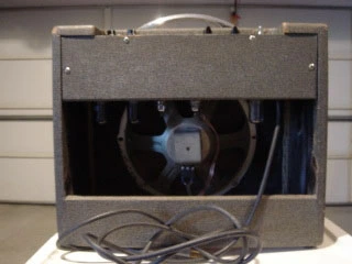

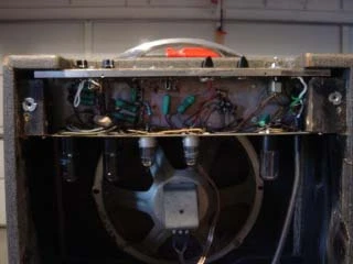

I got more details from the guy who actually did the mods, Dale Lasley from Greensboro:
"I restored this unit in February '06, it had been previously worked on and had a number of issues to be resolved (mainly low volume and poor tone). No schematic could be obtained of the original stock layout so it was resurrected as basically a single channel Fender Deluxe Tweed 5E3 with tremolo. It has two input jacks (1: normal, 2: extra gain) along with a wide ranging tremolo circuit that is foot switchable. The speaker is not original but is a vintage classic Jensen Alnico Special Design P12R that is a great match for this combo. The bias resistor (cathode type bias) was replaced to achieve proper output tube bias (~20mA). The power supply was completley rebuilt with all new capacitors and 1 watt resistors, all tube plate resistors also replaced, and a fuse was added. Missing tube sheilds were replaced, and a fat switch installed in place of the #3 input jack (adds in a 22mfd cap across the cathode of V1a). All pots and tube sockets were cleaned and adjusted as required. This amp was transformed into a gig machine, ready for many years of trouble free jamming."
Not sure if you can see anything from them, but here are some pics:

I went and tried it out tonight. Wow! What a great sounding amp. I wish it had 2 channels, but I will learn to adjust. That's the one I'm gonna get.
