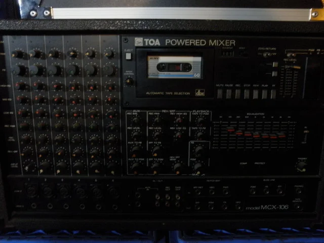

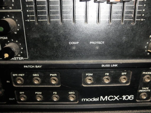

that said, years ago, i was in a pinch (as usuall)...and i used a couple cheap guitar cords for speaker cords on my TOA powered mixer board, and did notice the comp light, and eventually the "protect" light come on..the thing shut down down briefly after cranking it for a minute..it was okay at lower volumes, but not when bieng pushed a bit..at the time i thought it was on the verge of quiting, however, i now know that the guitar cables bieng used as speaker cables was more likely the issue...

here`s a pic of my old TOA, which i still have....
