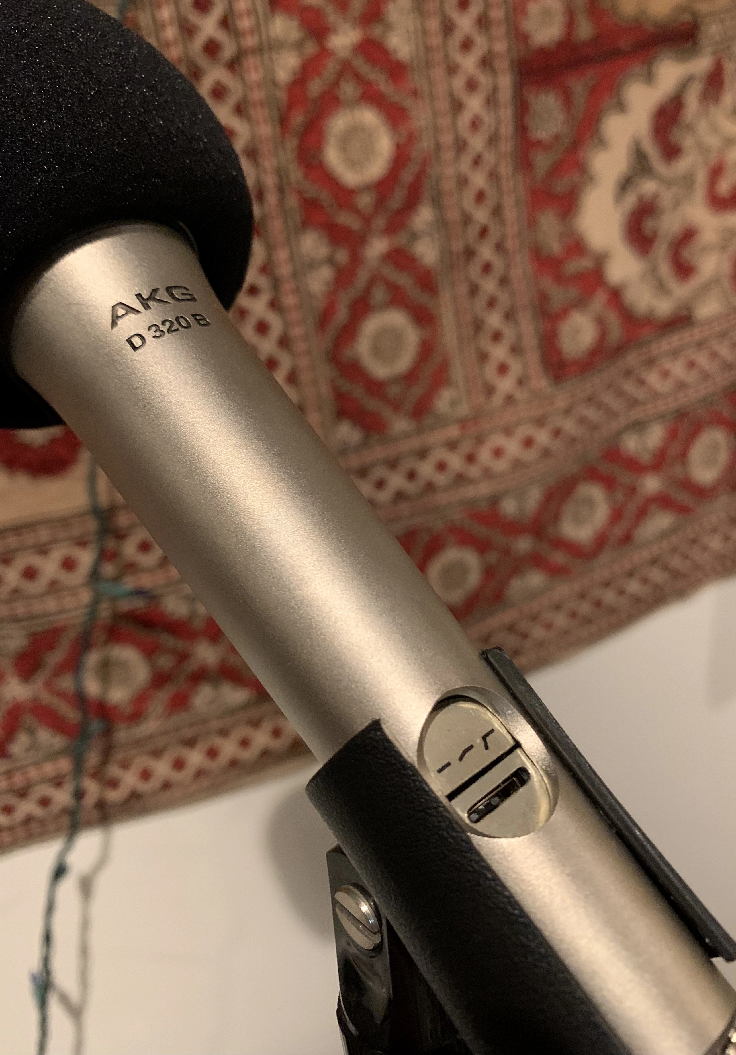

I bought two if these in1985 for about $45 each. I hadn’t used them much until recently and I love them. I mostly play flute and other wind instruments and they sound fine. I still don’t understand what the switch on them does yet, but I’m looking that up now.
 alt=
The switch if for a bass rolloff. You have two levels of reduction, -10 and -20dB/ octave at 100Hz.
Its a hypercardiode mic, fairly low sensitivity at 1.4mV/Pa and 290Ohm.
A nice mic. Like most of that vintage from AKG, a bit character-less. They seemed to go for flat and truthful sounding, when others were trying to make voices sound better. They might be good stage mics now, where people don’t like the Shure sound?
It's actually a very nice mic! First, I must disagree that it is a flat sounding mic- it's anything but. There is a +5 dB boost at 5k. But what is nice about the 320 is that extra high end is quite silky for a dynamic vocal mic. For a rock singing in a loud band that still uses wedges, it's hard to do better. The HF rolloff is *very* dramatic, so if that's what you need it sure works. But you're cutting -10dB or -20dB at 100Hz respectively. Also, these mics are built like tanks- AKG did monster drop tests and abuse testing to evaluate the multi-layer suspension. For the same reason, these mics have incredible rejection of handling noise and bumps. Good stuff that you can still get cheap, if you can find one. But I didn't have any luck picking any up for $60. These days it looks like $150 is more the going rate, and I went ahead and grabbed one.
