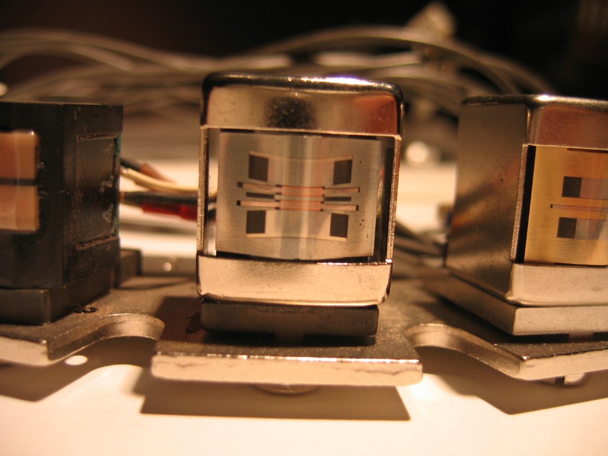

Does anyone know if using acetone to clean "Akai Glass & X'TAL Ferrite Head's" will damage the heads? I use acetone to clean the posts, but will it damage the heads if applied?
Keep acetone far, far away from any tape deck! I wouldn’t use it on anything that’s attached to a working machine. Maybe on certain individual metal parts while restoring a deck. Definitely not on tape heads of any type!
Alcohol is the best. Denatured alcohol, or 91% or higher Isopropyl have always been most common. The higher percentage the better for Isopropyl, but higher than 91% may be hard to find in some areas. 95% or 99% if you can find it. Some pharmacies keep the higher percentage stuff behind the counter, so you have to ask for it. Denatured alcohol can be found at any hardware store, like Lowes, Home Depot, etc. It comes in a can that looks like acetone, but never use acetone.

By the way, I've used this for the glass heads on my Akai GX-77 since about 1990. It's true what they say about those heads... they last forever. I bought it in 1988 and still runs like new.

The glass heads did have issues because they were brittle. A peakier profile on the face of the head was more problematic, and if a wear groove DID develop and they needed relapping it was/is difficult at best to do so because of the brittle nature.
You see the material used more often on erase heads partly because of the much flatter profile...they last a long time.

They used them up to 1/2" heads with 14 tracks. The Akia MG1212 and MG1214 1/2" multitracks had Crystal Ferrite Super GX heads. How ironic though that they used a proprietary tape cassette that is almost impossible to find. Had they used betamax as they were going to at first you’d see a lot more of these machines still in use.
It was estimated that the heads would hold up for over 17 years of continuous 24/7 operation and that estimate has pretty much been proven over time. No one has ever really used them that much, so you don’t find those heads worn out like you do traditional heads.
I would like to find one of the three Akai machines that used these heads, unusable because of no available tape, but with good heads. Then find a way to mount them on a Tascam MSR-16 or Fostex E16/G16. The Akai machines were officially ½” 12-track, but the heads were actually 14-track, with two tracks intended as sync and control tracks. I can get most of what I do done with 8-track, but I always thought 12-track was the sweet spot for those times when I could use a couple more, plus an additional one for sync. The ½” Akai heads come closer to my ideal for track count, track width, performance and durability than anything else I know of.
