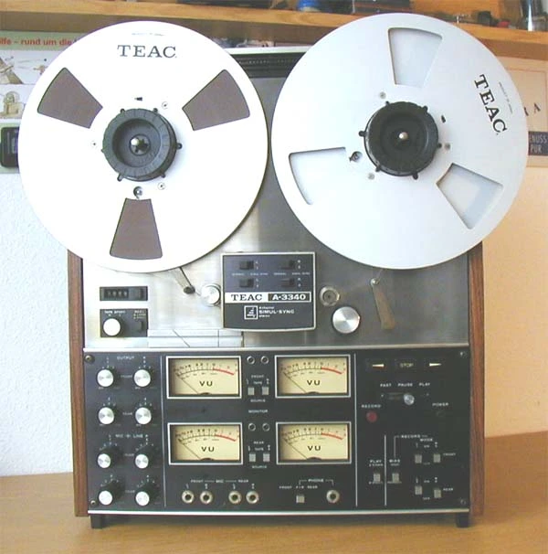

Okay, i was also considering a teac 3340. Those are a little bit more expensive, but they seem like quality machines. Do you think the 3340 would be a good choice as well?

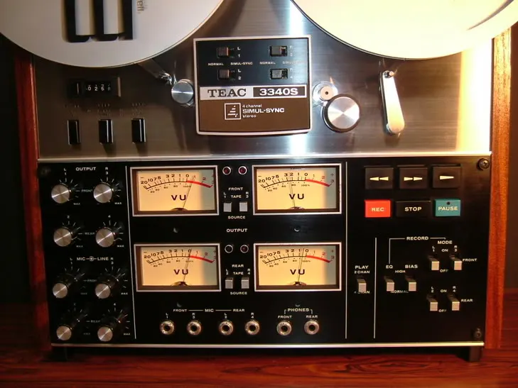

That's likely to be a lot closer to what you want, yes. One thing to check - I might be talking out of my arse here, but I have a sneaking suspicion there's two versions... the 3340 and the 3340S. If so, make sure it's the S-version because the original will not be able to overdub properly (the S-version added sync mode, the original may play the other channels 1/15th of a sec late). Hopefully someone else can clarify that.
The other thing is that the machine is likely to be about 40 years old so it may require some TLC unless it's being sold as recently-serviced.
I've not used one myself but others on the forum seem to rate them quite highly.
Both Teacs are simul sync machines.
The 3340 non S has a shuttle lever for selecting fast mode or standard play.
The S version has the typical array or pushbuttons and no lever. Among other improvements onthe S version, the shuttle lever elimination made it more reliable.
