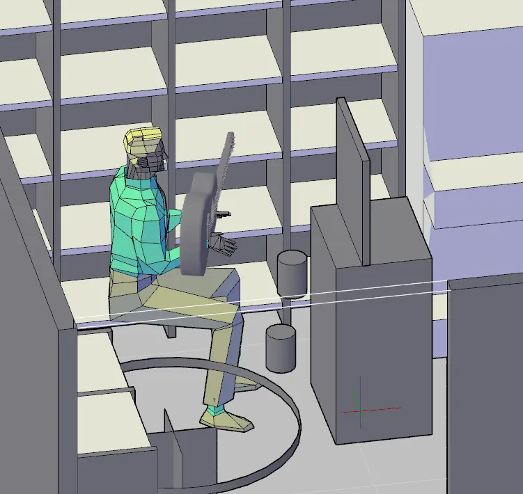

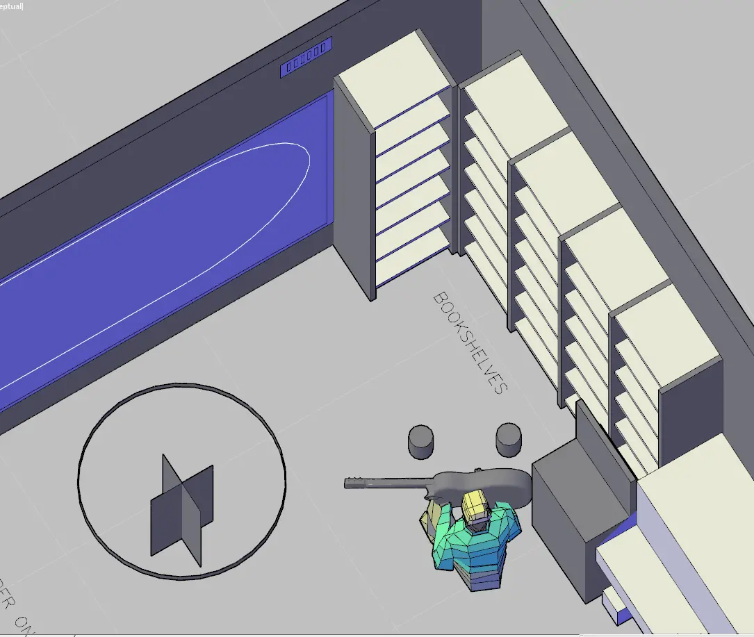

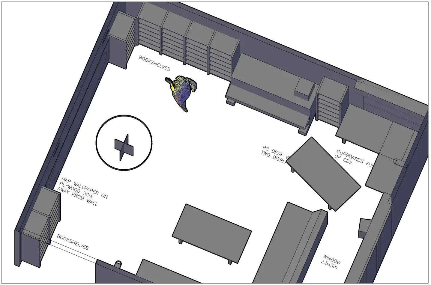

I would like to track acoustic guitar (steel string) and vocals (baritone like) at home.
I track into the living room and treating it properly it's not an option.
It's 5x6 meters and the lay out is like this:
I'm planning to play the guitar and sing in the area where there is the woman:
should I do it faced in the same direction where the woman is facing - towards the angled bookshelf, or in the opposite direction, towards the center of the room?
Mics: SE8, SP C1, SP TB1, AT 3035
The pc for tracking will be on the right side of the woman, just in front of the bookshelf near the piano.![3D.png 3D.png](https://homerecording.com/bbs/data/attachments/79/79120-409e4beaeda2a99259d661ccc660e440.jpg)
Thanks.
