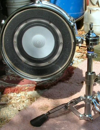

I would use the direct out...THEN use a Yamaha Subkick!
It works great on Bass Cabs.
Use them together in your mix. Sometimes the Direct will be best, sometimes a bit more Subkick!
The Subkick can really get that LOW, deep bass....when you want that...BEWARE! It can really overdrive things (board, monitors, etc.) be careful.

Yeah, or instead of paying $250 bucks to yamaha you can make your own....
Sure, that goes for alot of stuff....but the stand and hardware are almost worth that...VERY solid...
$250 is pretty cheap...can't buy much of ANYTHING decent for $250, nowadays! :(
shit, i could probably find someone with a crappy old snare and stand for free right now
and now that i think of it, i have a couple of 6.5" pioneer car speakers sitting in my closet
hmmmm....
stand and hardware do go along ways, but so does $250. If your using it on a kick drums simply run a string around it so it uses the fork of the toms, or you could even take a cymbol stand and hang it on that. If you look in the right places ( can't think of it offhand ) there's plenty of schematics and directions on how to build one.
