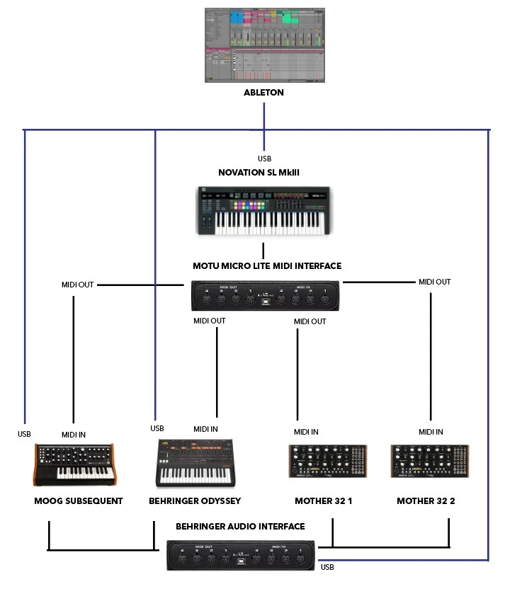

Here's a map of the new studio setup that I want to go for.
I need to control all of the synths via MIDI with a Keyboard Controller that allows me to sequence/ program, and also be the Clock Master for all of them.
I also need to have audio return, so I can also edit the sequences of Ableton MIDI clips if needed.
I'd like to know if I'm missing something important.
And I'm not 100% sure that I'm picking the right MIDI Interface. For several practical reasons:
- I don't want to use MIDI daisy chaining nor a smaller MIDI Interface.
- I don't to connect everything via USB.
