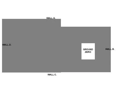

cellardweller
A=11FT. (*CARPETED* DRYWALL BOTH SIDES, FIBERGLASS INSUL. BETWEEN)
B= 8FT. 4IN. (*SCULPTURED CARPET * DRYWALL BOTH SIDES, FIBERGLASS INSUL. BETWEEN)
C=19FT. (VERY UNEVEN, OLD CINDER BLOCK)
D=10FT. 2IN. (VERY UNEVEN, OLD CINDER BLOCK)
CEILING= 6FT 4.75IN. NEAR WALL B,
RANGING TO 6FT. 2IN. NEAR WALL D.
(MY INTENTION IS TO FILL AREA BETWEEN FLOOR SUPPORTS (in my "ceiling")WITH “FLUFFY” FIBERGLASS ROLLS.)
FLOOR IS 90% CARPETED.
GROUND ZERO IS INTENDED MIXING AREA, BUT THIS IS ONLY TENTATIVE AT THIS POINT.
Oops, nearly forgot. Door is directly in area where "WALL A" text appears.

BTW- The picture is very disproportionate.
Sorry. Just to give some visual idea....

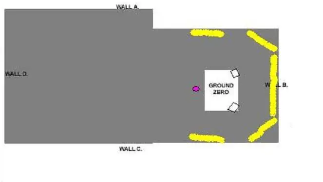

Here is the basic needs, not showing the rigid fiberglas between ceiling joists (at least over the mix area) -

Knightfly-
Your alterations... are they just freestanding rigid sheets w/fabric? Are some of them are membrane traps, which ones? I had planned to build a couple traps, as you and many others have said that in a room that small, low frequencies are the most prevalent problem.

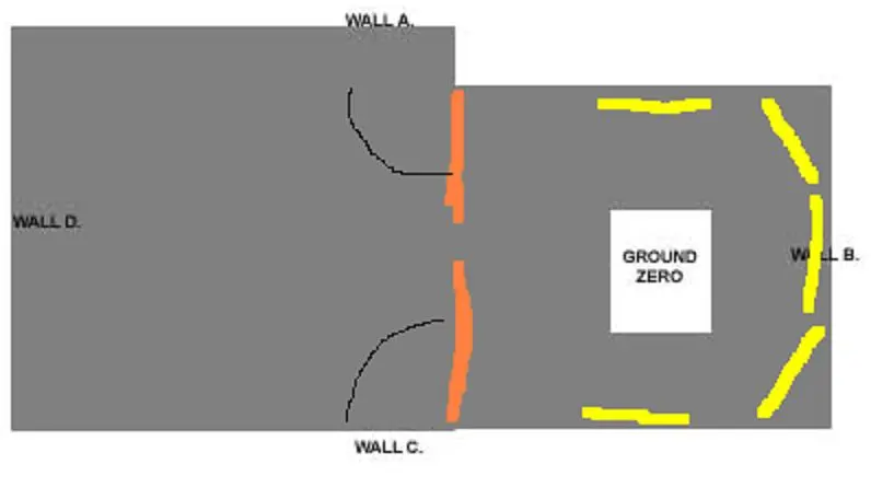

Hear is what I came up with.
They are swinging baffles.
They work fine for me.
Or Maybe just build a wall where I have positioned them with a door. And then make the other side the recording room.

Sorry, really long days lately - my suggestions were just cloth covered 703 or rockwool, frames as necessary to aesthetics. Panel traps should be built based on modal characteristics of the room for best results IMO. Another reason for panel traps in place of broadband absorption would be if the room is already dead enough but too boomy... Steve
I used 2x4 framing with mine. Mortised the hinges 3 of them evenly spaced. Srewed down some partical board on it. Then hung it leaving an 1" gap all the way around the perimeter. Stuffed it with 3 1/2 " of rigid fiber. Then covered(using a electric stapler) it with fabric of your choice. I used canvas. But I believe linen allows for more perforation allowing more sound to be absorbed.
